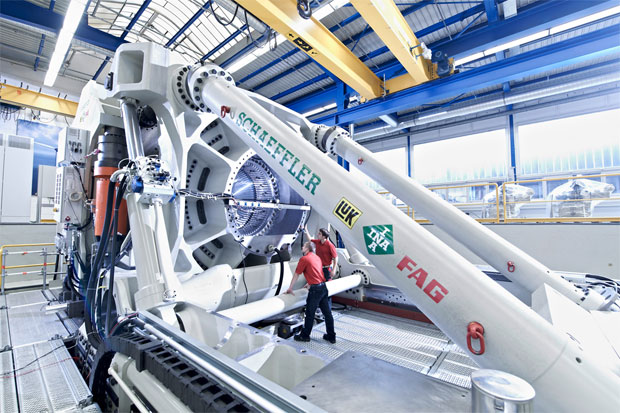

Realistic tests on Schaeffler ASTRAIOS
The calculations are enhanced and validated on powerful test rigs. Bearings up to 3.5 meters in outside diameter can be tested on one of the most state-of-the-art and biggest large-size bearing test rigs in the world. ASTRAIOS simulates the real loads and torques which occur in a wind turbine. Thus, Schaeffler contributes decisively to a faster and more reliable design of wind turbines and increases their cost-effectiveness and safety.
