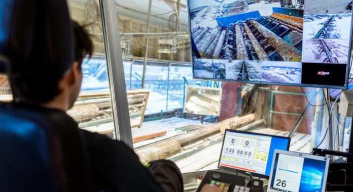

The sawmill operator easily detects changes in the parameters calculated using the integrated SmartWeb webserver.
