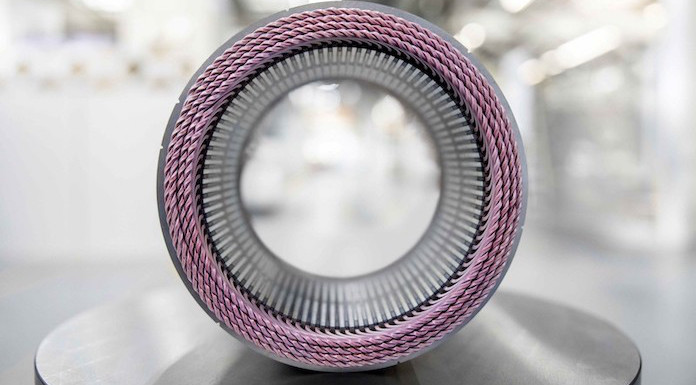

Electric motors from Schaeffler offer maximum reliability along with maintenance-free operation. They are used in traction drives or in auxiliary units of agricultural machinery. To meet the growing customer demand for high-voltage systems in a compact design, Schaeffler offers innovative solutions based on flat wire winding technology with hairpin and wave winding (continuous hairpin). A compact design is achieved thanks to a high degree of copper filling, reduced iron and magnetic losses, and improved heat dissipation.
As traction drives or auxiliary units in agricultural machinery, electric motors from Schaeffler offer maximum reliability and maintenance-free operation.
