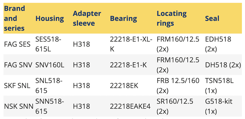

Let us look at some possible combinations:

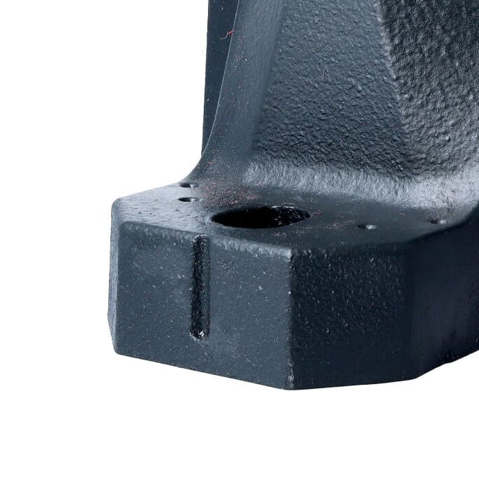

The dimensions of SES housings are standard dimensions. Old housings can be replaced without any problems. Another good thing: the type numbering is based on the other manufacturers’ system. In addition, SES housings can be aligned quickly and accurately. Clear markings indicate the centre of the bearing and shaft. Grease openings make sure any excess or old lubricant can easily be removed. Also, it is possible to connect a condition monitoring system. To measure is to know! SES housings will keep downtime to a minimum.
