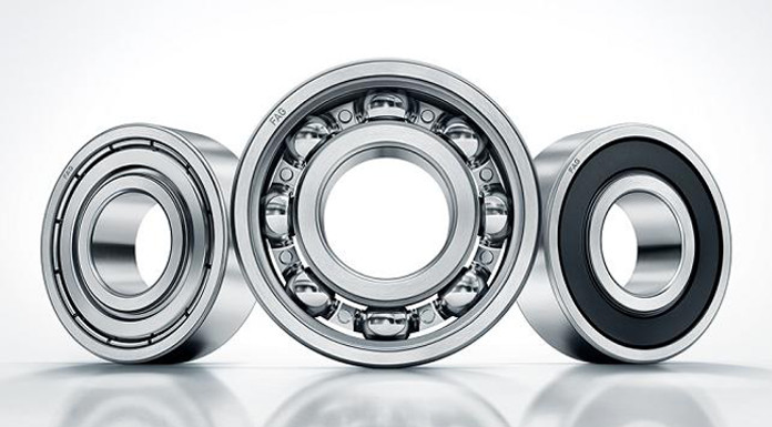

Schaeffler is significantly expanding its standard rolling bearing business with FAG Generation C deep groove ball bearings by investing in new production and logistics capacities, as well as improved product features. Electric motors, household appliances, pumps, fans, electric power tools and two-wheeled vehicles are the most common applications for Generation C bearings.

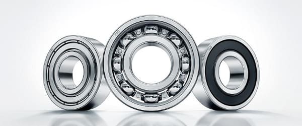

Schaeffler is significantly expanding its standard rolling bearing business by investing in new production capacity for its FAG Generation C deep groove ball bearings. Improved product features, a new logistics concept, and optimum value for money make Schaeffler’s deep groove ball bearings even more attractive.
Schaeffler is significantly expanding its standard rolling bearing business by investing in new production and logistics capacities for its FAG Generation C deep groove ball bearings.
Over the coming months, Schaeffler will gradually bring new production lines into operation at its Yinchuan (China) location, doubling its manufacturing capacity for high volume FAG deep groove ball bearings. The most common applications for Generation C bearings are electric motors, household appliances, pumps, fans, electric power tools and two-wheeled vehicles.

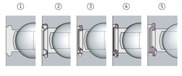

Schaeffler products continue to set benchmarks when it comes to important technical characteristics such as minimising friction and noise. Two new sealing concepts have also been developed. Reduced grease loss and better protection against contamination extend the grease operating life and therefore the operating life of the bearing. The new Z-type dust shield with its innovative labyrinth seal, helps to reduce grease loss by 20%, and reduces contamination by 30% compared to the previous design. The patented ELS lip seal (optional) provides maximum sealing at low friction and is particularly suitable for alternating axial loads, such as those found in the wheel bearings of motorcycles. This improved sealing, without any additional friction losses, is due to the innovative shape of the lip, which is perfectly matched to the ring recess. Furthermore, the recesses have now been moved to the interior of the bearing, significantly improving its robustness during handling and mounting. In addition, non-contact BRS lip seals and HRS lip seals, which start at the inner ring, are available with increased sealing performance in the standard range.

Various sealing concepts in the standard range for different requirements (from left to right): Open bearing, gap seal on both sides (2Z), lip seal on both sides (2HRS), lip seal on both sides (2ELS), non-contact seal on both sides (2BRS).
