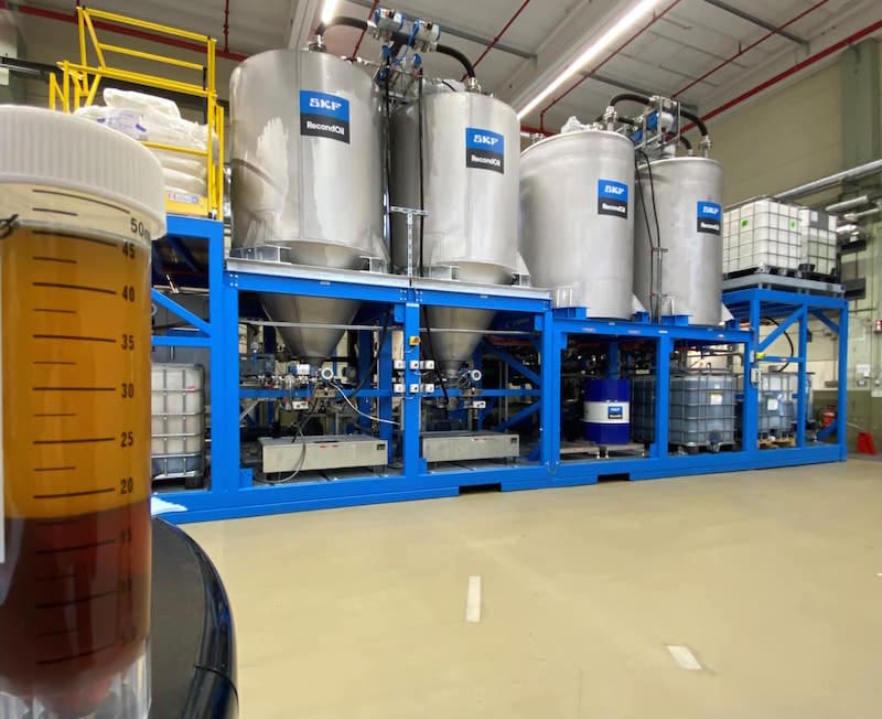

SKF has been awarded a EUR 1.62 million grant from the European Commission to install and operate a stand-alone processing plant for regeneration of industrial oils in Tudela, Spain. The project will use the innovative Double Separation Technology (DST) developed by SKF RecondOil to remove contaminants from used oils, and return them to a cleaner, usable and high-grade state.
The Tudela installation is the most recent addition to the growing number of DST systems in SKF’s manufacturing footprint. The technology is already in place at multiple sites in Europe, the Americas and Asia. Early results from the installations show that honing oil and filter consumption has decreased significantly, and product quality has improved as a result of the clean oil.
“With this technology we can achieve unprecedented levels of oil cleanliness that enable repeated reuse of oil in the same application. Our service is a technological breakthrough, targeting the implementation of the patented technology at significant commercial scale”, says Carl Philip Fredborg, Teamleader, Deployment and Aftersales at SKF RecondOil.
The DST combines chemical and mechanical separation processes. In the first step, a specialized chemical composition, called a booster, is added to the oil. The booster attracts dirt within the oil – all the way down to nano-sized particles – while leaving essential oil additives intact. In the second step, all the dirt is separated from the oil, leaving a clean oil that can be continually regenerated.
