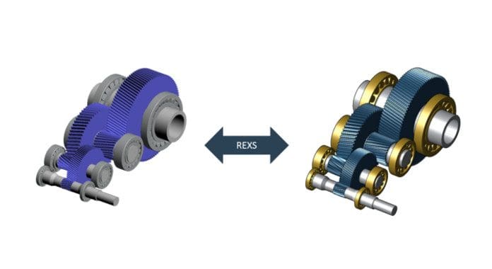

The first practical implementation of the REXS interface was the exchange of data between the FVA Workbench, Shaeffler’s BEARINX, and SEW’s WESILAB software.
3-stage parallel shaft gearbox from SEW in Bearinx and FVA Workbench
