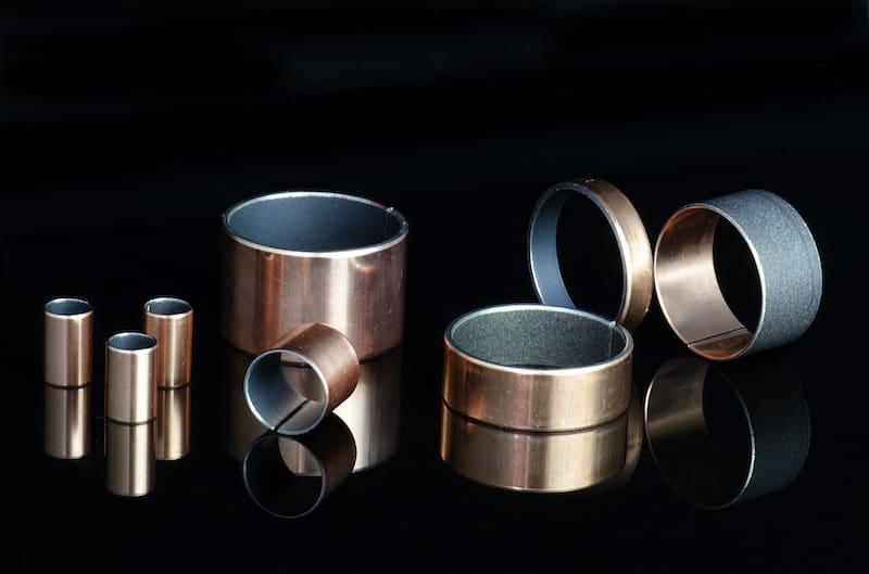

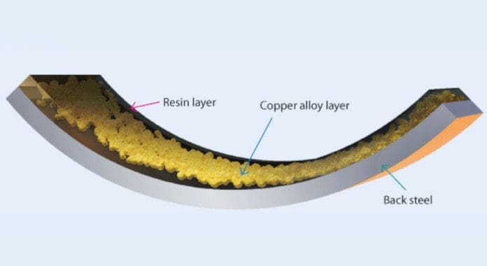

SMIC offers two types of plain bearings: “Clean Metal” metal-polymer composite bearings (Photo 1) and bimetal bearings. Metal-polymer composite bearings consist of a porous bronze sinter layer on a steel back, which is impregnated with fluorine-based polymer to achieve a low coefficient of friction (Figure 1). The permittable temperature ranges from -200°C to 280°C. The original polymer layer shows high lubricity and can be used without additional lubrication. In order to meet requirements specific to application, performance and operational environment, SMIC has developed products responding to different needs, e.g. low friction, high load or high rotation, suitable for a multitude of automotive applications including shock absorbers (Figure 2, Figure 4).

                                              Three layered structure of Clean Metal material (Figure 1)
