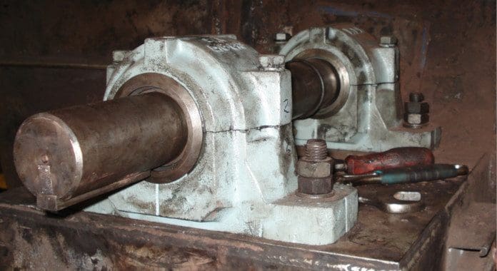

When an ore preparation plant began experiencing repeated bearing failures on an air recirculation fan, it turned to NSK for advice. As a makeshift countermeasure, the facility was applying compressed air cooling in an attempt to reduce elevated bearing running temperatures, so the requirement for an urgent long-term solution was clear to see.

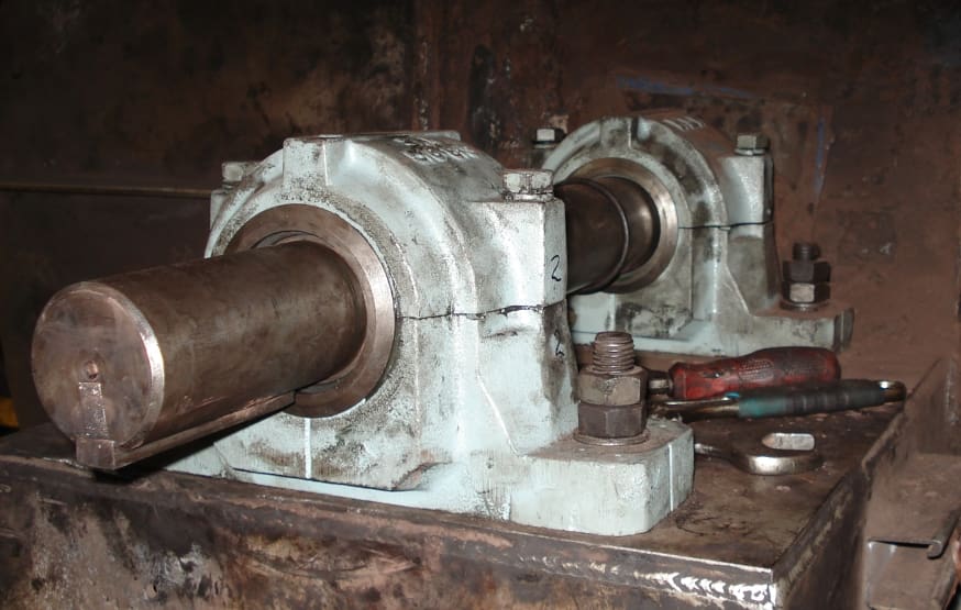

                                 The air circulation fan shaft and bearing blocks at the ore preparation plant
NSK’s expert team of engineers carried out an application review as part of its AIP Added Value Programme. This task included a temperature survey of the fan and bearings, which revealed that the bearings had been fitted incorrectly. In addition, excessive lubrication was evident, as was an inadequate sealing arrangement.
To counter these issues, NSK recommended switching to its high-performance NSKHPS Spherical Roller Bearings within NSK SNN Plummer Blocks and NSK Labyrinth seals. This move, along with recommendations for correct fitting, optimum lubrication intervals and quantity, would serve to overcome the plant’s previous issues.
NSKHPS bearings are specifically designed to carry greater loads and operate at higher temperatures
To test the theory, a year-long trial was commenced, with NSK overseeing the installation and implementation of the recommendations. The results of the trial saw no bearing failures at any point in the 12-month period.
NSKHPS bearings are specifically designed to carry greater loads and operate at higher temperatures, offering temperature stability up to 200°C. With these attributes, users can achieve up to twice the operating life and enhanced reliability.
NSKHPS Spherical Roller Bearings were supplied within NSK SNN Plummer Blocks for the ore plant application
The customer was soon able to testify to these benefits, enjoying increased productivity, reduced maintenance and the removal of compressed air, all of which have resulted in a significant cost saving. Factoring in time and labour costs due to bearings failures, as well as the cost of compressed air, means the plant is now saving €393,706 per annum.
