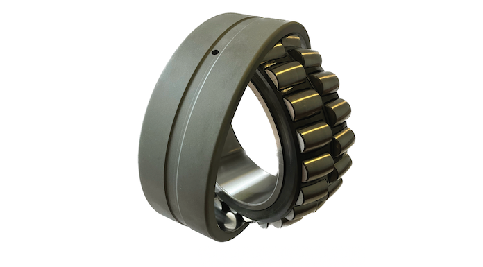

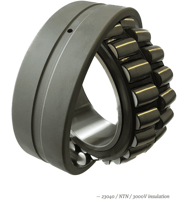

DUROCOAT – DC
ELECTRICALLY INSULATEDVBEARINGS AND COMPONENTS
Our ceramic coatings can be applied on any brand, onto most of radial and thrust bearing types, inner or outer ring or on any other component.
The insulations are not restricted to a specific bearing brand, anyone can be coated. The ring receiving the coating will be reworked by us, the bearing performance data remain the same. Based on our cooperation with bearing manufacturer in Europe and Asia the bearing rings can be already produced with appropriate dimensions for direct coating in Austria without additional pre-processing. This way electrically insulated bearings become highly competitive.
All tolerances remain the same, the bearings and components are ready to install.
The electrical resistance and breakdown voltage are 100% process controlled, available are layers from 70 to 300μm, offering a dielectric strength from 500V to 3000V.

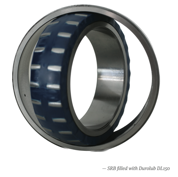

DUROLUB DL – POLYMER LUBRICATION SOLUTIONS
Durolub DL is filled into the free space of the bearings and then specially heat treated. The bearing contains about 3-5 times more oil compared to bearings filled with grease. Durolub base oils are used very efficiently just at the amount needed for lubrication. At standstill the oil is soaked back into the polymer matrix.
Beside an considerable extended service life, the seals are supported and cannot be pressed inside while washing with high pressure.There will be no condensed water inside the bearings or any leakage by operating vertically.
Durolub is offered with three different synthetic base oils, two variants with a standard viscosity for ball bearings or roller bearings and one for low temperature applications.
All Durolub DL executions are NSF H1, Halal and Kosher approved, made inhouse THB and available shortterm with no minimum quantity.

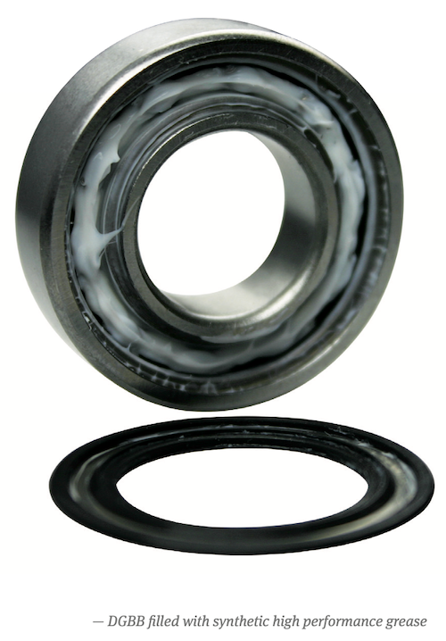

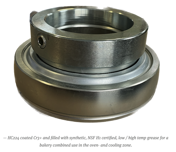

DUROLUB G – SPECIAL LUBRICATION / SPECIAL BEARINGS
Specially lubricated bearings are difficult to get and even if they are available, their prices are mostly sky-high.
With Durolub G, THB relubricates existing bearings with high performance greases to your choice. There is a full assortment of greases available, made in Europe or overseas.
For most efficient and economical solutions THB offers a full range of special bearings. They can be coated – filled with special lubricants – equipped with high performance seals – made of special ring materials – be hybrid with ceramic rolling elements.
