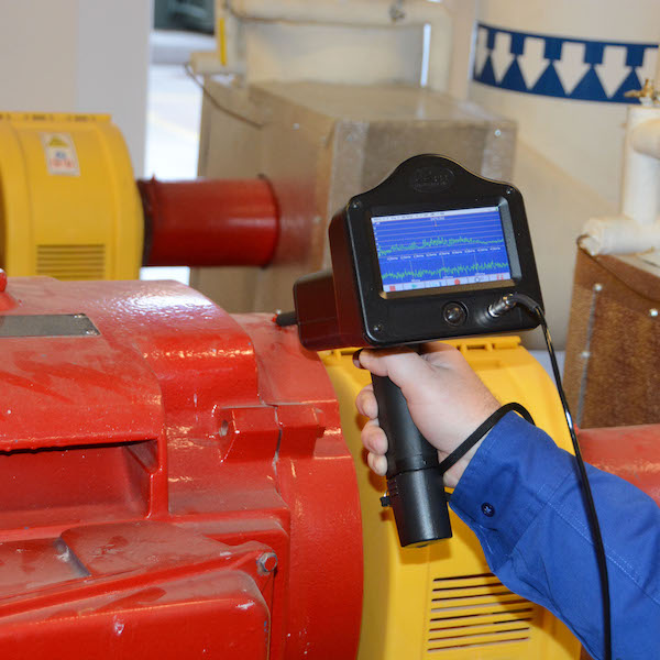

Slow speed bearing monitoring with ultrasound isn’t as difficult as you might think. Because most high-end ultrasound instruments have a wide sensitivity range and frequency tuning, you can listen to the acoustic quality of the bearing, especially at slower speeds.

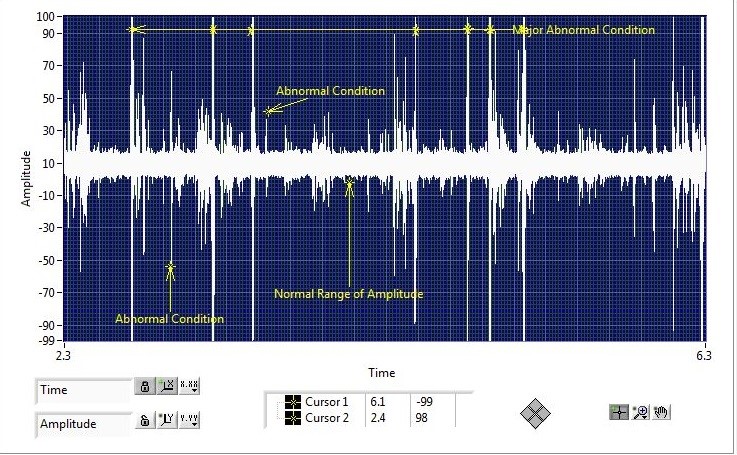

In extreme slow-speed bearing applications (usually less than 25rpm), the bearing will produce little to no ultrasonic noise. In that case, it is important to not only listen to the sound of the bearing but more importantly to analyse the recorded ultrasound sound file in a spectrum analysis software, focusing on the time waveform to see if there are any anomalies present. If “crackling” or “popping” sounds are present, then there is some indication of a deformity occurring. In bearing speeds above 25rpm, it is possible to set a baseline decibel level and trend the associated decibel level readings over time.

The primary function of an ultrasound device is to turn high frequency into audible sound. This is called heterodyning. An operator who knows the basics of bearing friction can distinguish a healthy bearing, producing a quiet steady signal from a defective bearing, causing an intermittent or specific repetitive ringing or crackling sound. However, listening is not enough. Reliable measurements are required to build a solid PdM program. Otherwise, your instrument is no more than a stethoscope.
Especially for slow speed bearings, one must rely on the sound quality and the sound pattern. For this, it is necessary to use an ultrasonic instrument with sound recording capabilities, like the Ultraprobe 15000, and then analyse the sound file on a sound spectrum analysis software like the Spectralyzer from UE Systems. Then, maintenance professionals can simply record the sound produced by a slow-speed bearing, load the file in Spectralyzer and analyse it in the Time Series view.

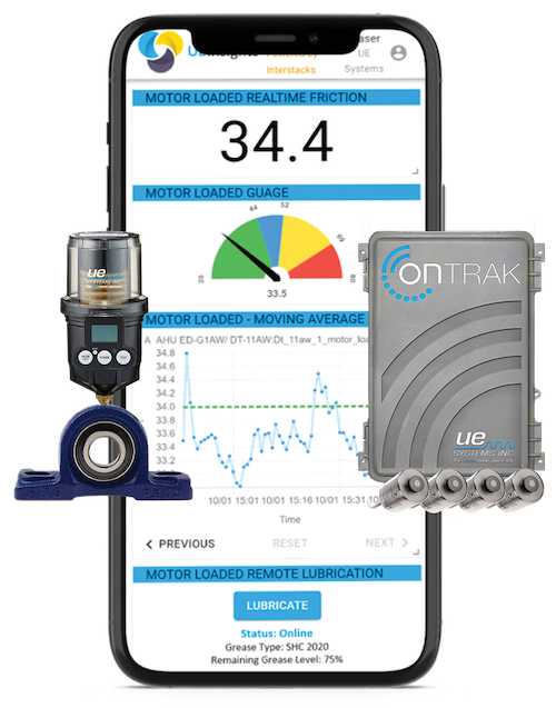

For slow-speed bearings, it’s crucial to rely on sound quality and pattern. To facilitate data analysis, it’s recommended to use an ultrasonic instrument with sound recording capabilities, like the Ultraprobe 15000 or the OnTrak system, which can manage the life of your bearings and significantly reduce the number of bearing failures caused by improper lubrication. After the sound has been recorded, it is then analysed on sound spectrum analysis software. Then, maintenance professionals can record the sound produced by a slow-speed bearing, load the file in the software, and analyze it. This software provides valuable insights into when a bearing needs to be lubricated or replaced if failure is imminent.
