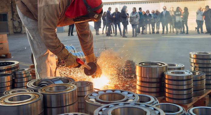

Spain, December 2019: only after the proceedings were concluded did Schaeffler receive permission to destroy the parts that had been seized in 2010.

Spectacular destruction of goods in Spain
During a raid that took place in Spain in 2010, large quantities of counterfeit Schaeffler bearings were identified. The subsequent legal proceedings took nine years to complete, and it was not until December 2019 that the goods that had been seized could finally be destroyed. Those who might have purchased these counterfeit bearings were therefore saved from both technical damage in potential applications and financial losses.
