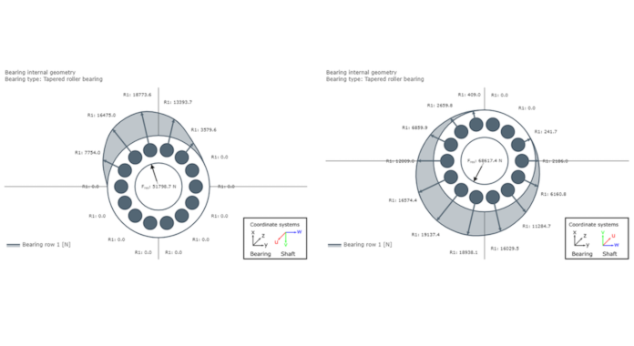

It can be seen that the deflection of both cylindrical roller bearings of the output shaft is nearly identical (Figure 2, right). In contrast, there is significant misalignment on the drive shaft. This is largely due to the so-called centering effect on the right tapered roller bearing. In the left bearing, only the rolling elements in the direction of the radial force are loaded (Figure 3, left), causing the bearing to deflect in this direction. In the right bearing, the restoring force on the shaft resulting from the radial force and the contact angle is lower than the applied axial force from the gearing. As a result, the shaft is pushed into the bearing so that the rolling bodies are in contact across the entire circumference (Figure 3, right). Thus, the shaft deflects only slightly in the direction of the radial force.
Figure 3: Representation of the left bearing (with a load range < 180°) and right bearing (with a load range across the entire circumference) in the FVA-Workbench
