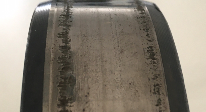

In roller bearings, there is line contact between the rolling elements and the raceway. If the rolling elements are perfectly cylindrical (cylindrical roller bearings) or tapered (tapered roller bearings), this leads to local pressure peaks when the end side of the rolling elements comes into contact with the raceway (Figure 1a). This can result in local pitting damage in these areas (Figure 2). To avoid these pressure peaks, roller bearings are always designed with profiling along the longitudinal axis of the roller (Figure 1b). In addition to avoidance of high edge stresses, the profiling also has an influence on the following criteria:

Figure 2: Local pitting as a result of profiling created by wear
