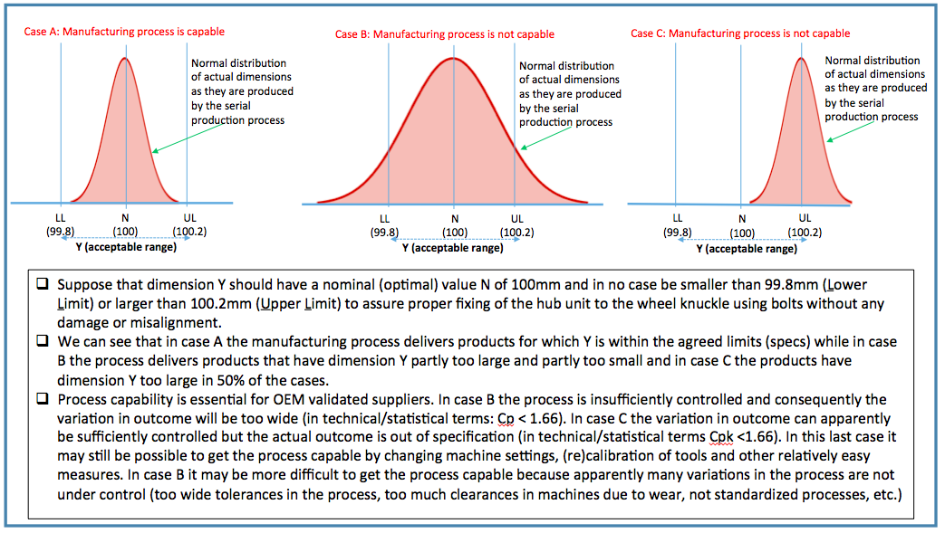

- A Process Capability Report – demonstrating that the manufacturing process is capable of keeping any critical dimension consistently within specification limits (represented by the so called “Cp value”) and that machine settings are such that the normal distribution mean value of such critical dimensions are actually close enough to the nominal specification value (represented by the so called “Cpk value”) – See the case study for an example from the auto bearing industry.

As can be understood from the above discussion the main characteristic to prove the suitability of the serial manufacturing process is the process capability. All critical dimensions and properties of the product design will have to be produced within well-defined limits (specifications) to make sure that the serial mass production parts have the same quality and performance as the final prototype part that was approved on the prototype car after surviving all types of bench and field tests during the development phase of the new car model.

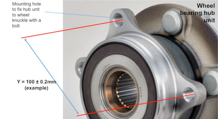

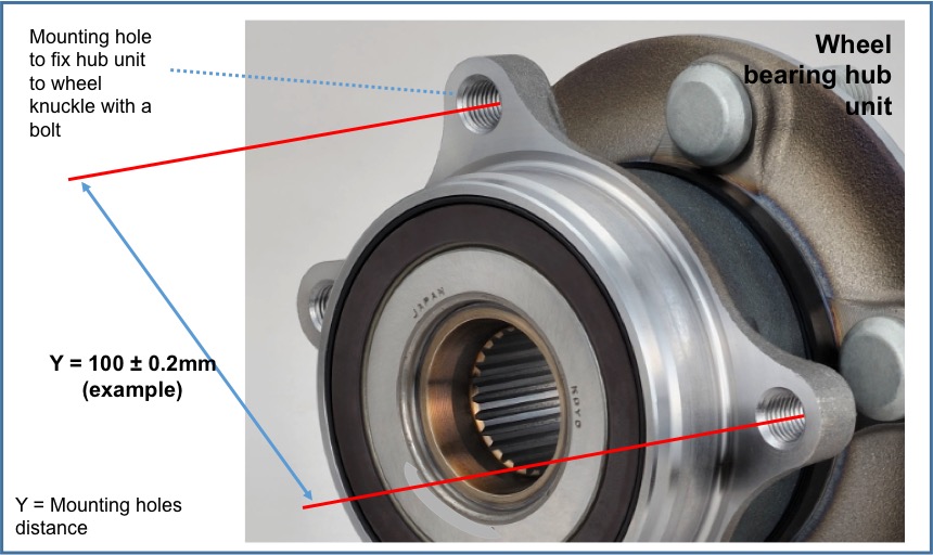

In the attached case study we can see the importance of the capability of the manufacturing process that assures the proper dimensions between fixing holes on a wheel bearing hub unit. For automotive OEMs part mounting dimensions are very critical. In this case the position of the holes should be exactly the same as the position of the holes on the wheel knuckle to which the wheel bearing unit needs to be fixed. If the dimensions are out of specification there will be a serious risk of misalignment during the mounting of the bolts or damage to the thread (resulting in poor fixing of the wheel hub to the wheel knuckle) leading to an unacceptable risk of failure.
