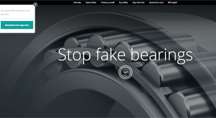

It is always recommended by the WBA and the manufacturers, that if there is no code, or the authenticity is in question, you should contact the manufacturer to be sure. Customers can easily reach out to the manufacturer directly to ask questions about the authenticity of the product directly through the app. The WBA Bearing Authenticator is currently supported by the leading international manufacturers — JTEKT (Koyo), NACHI, NTN, NSK, Schaeffler, SKF, and Timken.
For more detailed information about counterfeit bearings or app download instructions, visit: https://www.stopfakebearings.com/.
