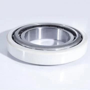

What About Hybrid Bearings?
Hybrid bearings, with ceramic rolling elements, are immune to electrical damage, and insulated bearings with a thin layer of alumina around one race (usually the outer race) are highly resistant. These bearings are electrically robust, but they are also expensive. Another drawback is that, while they block current flow through the motor bearings, they do not protect the bearings of the equipment the motor drives. So you would also need an insulated coupling to protect the equipment bearings. It only takes one insulated bearing to interrupt high-frequency circulating current, though, and this approach can be used in conjunction with other measures against shaft voltage discharge and rotor ground current.
