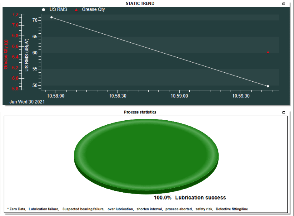

As it was time to replenish the grease in both motors (according to those 4000 hours), we used the opportunity to do it. But this time with LUBExpert.
After couple of minutes of basic instructions to Mr. Serdar, he was on his way to replenish grease based on real condition and real bearings’ needs. We did nothing, we simply enjoyed the scene.
And, surprise, surprise… what happened during grease replenishment was not even close to what time-based recommendations were directing Mr. Serdar to do.
Fan 2 Motor NDE:
Planned quantity: 13 grams / proven wrong
Applied: 6.5 grams
Outcome: Lubrication success
Fan 2 Motor DE:
Applied: 5.2 grams

In addition, LUBExpert collected Dynamic data (TWF and Spectrum) for each bearing before and after grease replenishment process.
That makes Mr. Serdar a member of the Condition Monitoring team, providing highly valuable data.
Before:
After:
