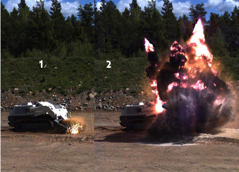

The Digger D250, with its rapidly turning tiller, crushes the soil and explodes the anti-personnel mines and anti-tank mines.

In a current test at the Swedish EOD and Demining Centre/Swedec, the Digger exploded 450 anti-personnel mines and three anti-tank mines with up to 8 kg of TNT and the Timken® bearings continued to function flawlessly
“I am proud to work for a company that is willing to contribute its expertise and products to the noble efforts of the Digger Foundation,” said Michael Hinterreiter, senior sales engineer at Timken. “Our spherical roller housed unit bearings have proved themselves in one of the hardest tests possible – at the Swedish EOD (explosive ordnance disposal) and Demining Centre/Swedec. The Digger exploded 450 anti-personnel mines and three anti-tank mines with up to 8 kilograms (17.6 pounds) of TNT – and the bearings continue to function flawlessly.”
