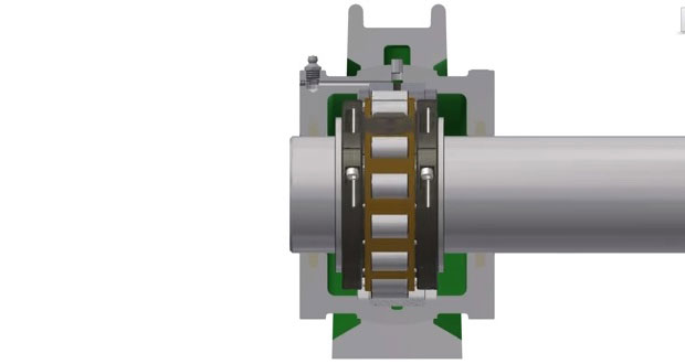

Split cylindrical roller bearings, on the other hand, are significantly easy to install because of their unique design. “Because every component in the split bearing is literally split in half, you can physically build the bearing around the shaft without removing all the associated equipment next to it,” Dent says. They can also be interchanged with existing split and solid bearings for any style housing ranging from 1-3/16” to 24”.
Mark Flaherty, Manager of Sales and Marketing at Timken Housed Units reveals the secret: “With the  SAFQ or SNQ Quick Series Housed Unit, the support pedestal is split at an angle which allows you to slide it right under the shaft—for faster, easier installation.”

In addition, Timken split cylindrical roller bearings use a highly engineered machined brass cage that can handle higher speeds, temperatures, and acceleration.
“The brass cage and its innovative jointing clip is essentially the best technical option available on the market today,” Dent said.  “Aluminum and pressed steel cages are limited in their performance.”
