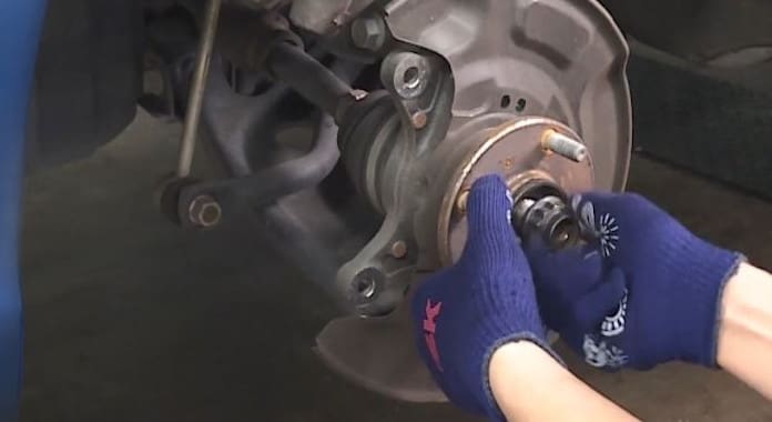

Ensure correct encoder orientation
Encoders are only present on one side of Hub I generation wheel bearings – as identified by the test card – so it is vital to get the orientation correct when pressing into the knuckle. Before beginning this operation, always check that the encoder surface will be adjacent to the sensor after assembly.
Avoid pressure on the encoder surface
For pressing, use a tool that only contacts the end face of the outer ring on Hub I
generation bearings (Image 3). Never press on the encoder seal and never press on the
inner ring as it will lead to bearing failure within a few kilometres of use. Once a suitable tool has been selected, keep the bearing aligned to the bore and press it vertically into the knuckle.
Further tips for correct bearing installation
There are many general tips to keep in mind throughout the process, such as taking care of all suspension parts to avoid any unnecessary damage. Additionally, to ensure correct fitting of the bearing, it is especially important to control the hub and knuckle during assembly, while all surfaces which come into contact with the bearing should be cleaned beforehand (Images 4 and 5).
As a final point of note, for safe reassembly, technicians should only use only the recommended tightening torques recommended by the car manufacturers. In particular, it is known that applying excessive torque to the CVJ nut can lead to bearing damage (Image 6).
