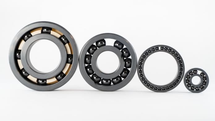

Bearings may not dominate the headlines in aerospace design — but they are fundamental to the smooth and precise operation of a wide range of systems. From flight control actuation and avionics to satellite navigation, instrumentation and cooling fans, aerospace bearings are everywhere — and in modern systems, they are getting smaller and more specialised.
Miniature bearings, often just a few millimetres in diameter, are essential in space-constrained assemblies. These are typically used in high-speed rotating parts where precision and stability must be guaranteed, despite thermal variation or vibration. For example, in gyroscopic stabilisers, navigation units or electromechanical actuators, a failure in bearing performance can compromise the accuracy — or even the safety — of the system.
