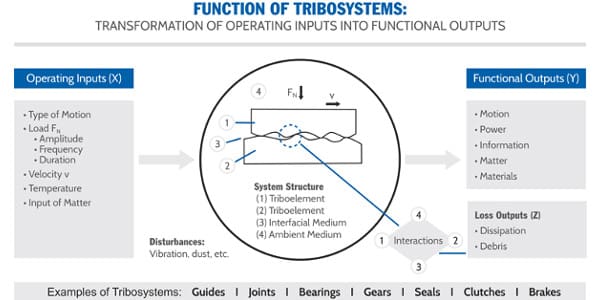

Tribological systems 123
Friction and wear are not material properties. They are responses to a specific tribological system which typically includes a bearing, shaft and lubricant combination and as such are influenced by a wide range of factors. The tribological sub-system in Figure 1 provides an overview of common factors which affect friction and wear values:
This tribological system is composed of the collective stress/operational inputs, system structure and the functional and loss outputs. The collective stress includes the technical and physical load parameters including load, sliding speed and duration along with the movement and temerature conditions stressing the system-structure. The system-structure is determined by the property profiles of the substantial elements including the base, opposing body and ambient and the intermediate medium.

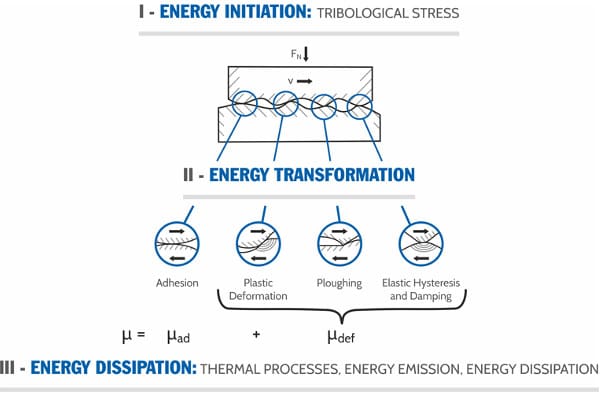

Friction is the force of resistance to motion between two bodies in contact. Friction can be described on the macroscopic level by the basic laws of friction from physicists Guillaume Amontons and Charles-Augustin de Coulomb. These physicists found a linear relationship between resulting friction force and applied normal load. Based on this, a dimensionless main parameter can be derived, called the coefficient of friction. It is defined by the ratio of the resulting friction force and applied normal force.
However, the actual mechanism of sliding friction occurs at a microscopic level, which means tribological theories on friction also involve the topography of the surfaces. The tribologist differentiates between the real contact area and the nominal contact area (geometric dimensions), which accounts for any voids or non-contacting portions of a solid element. The mechanisms responsible for the energy transforming process in the near surface area include:

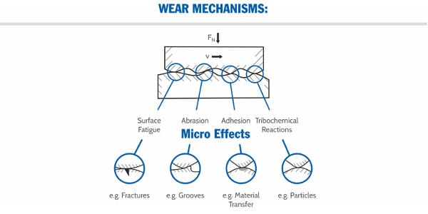

Wear is defined as the irreversible material loss of interacting surfaces. Physical and chemical elementary processes within the area of contact of a sliding pairing subsequently leading to change in material and shape of the friction partners are known as wear mechanisms. These wear mechanisms include:
Friction and wear mechanisms are strongly affected by the structure of the tribological system as well as on the induced collective stress:
µ=f(tribo-structure(t),induced collective stress(t))
w=f(tribo-structure (t),induced collective stress(t))
Friction and wear mechanisms do not occur in an isolated fashion, but rather through a superposition of mechanisms that is challenging to quantify and control for. This superposition occurs in tribo-technical systems in non-detectable proportions and in proportions that vary across time and place, making it nearly impossible to calculate friction and wear processes in a tribo-contact. This is why tribological tests are so crucial for estimating tribological behavior. If we want to interpret and understand tribologically-measured data and mechanism-oriented research, we need complete knowledge of the acting mechanisms in a tribo-contact.

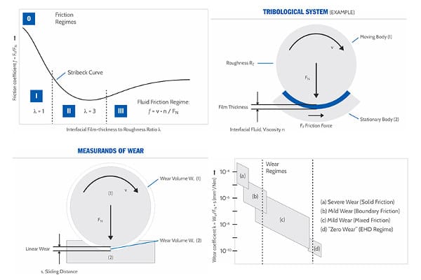

Tribologists classify friction, wear and lubrication conditions according to the following schedules:
- Friction Regime 0: Solid friction: Friction is created between direct contacting solid surfaces without any lubricant.
- Friction Regime I: Boundary friction: Solid friction, in which the surfaces of the friction partners are covered with a molecular lubricant film that has no load carrying capacity. The Lubricant has an influence on the friction and wear characteristics.
- Friction Regime II: Mixed friction: Friction regime I and III co-exist. The friction value is a combination of solid and hydrodynamic friction. A fluid film created by the lubricant has a load carrying capacity.
- Friction regime III: Hydrodynamic friction: Friction value is determined by shearing in the fluid. The load carrying capacity of the fluid film prevents direct contact between the two solid surfaces.
- Wear regime a: High wear rates due to solid friction and direct contact of surfaces.
- Wear regime b: Lower wear values due to a molecular fluid film.
- Wear regime c: Mild wear due to a partial separation of the surfaces through a thicker fluid film.
- Wear regime d: “Zero wear,“ resulting from hydrodynamic or elastohydrodynamic fluid films that prevent direct contact of the two surfaces.

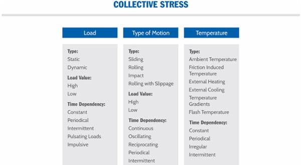

1. The induced collective stress including:
- Nature of the load
- Nature of the motion
- Temperatures
- Time factor
