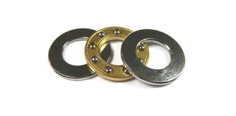

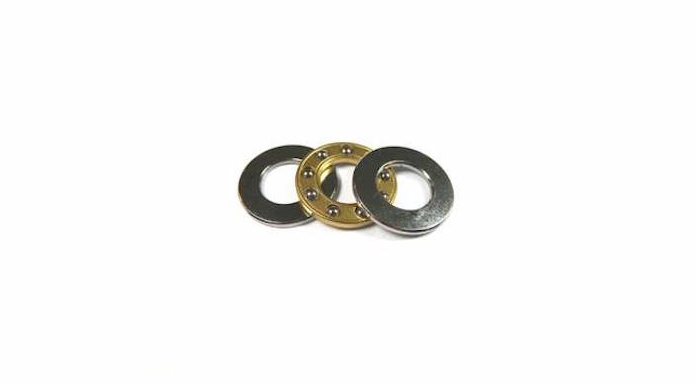

Miniature thrust bearings, sometimes referred to as axial bearings, are often used for low-speed applications like these. The bearings should not be subjected to a radial load as they are designed for thrust loads only. For applications with a combination of the two load types, thrust bearings are often used in conjunction with radial ball bearings, so that a thrust load and a radial load can be supported.
It is important to use the correct type of miniature thrust bearing. Some have a raceway or groove on each washer. In these instances, one washer has a slightly larger inside diameter so that it is located in the housing and the shaft can rotate inside it. These bearings can accommodate thrust loads in one direction only and must be fitted according to the load direction.
The simpler type of miniature thrust bearing has identical washers and no raceway. These can accept thrust loads in either direction but have much lower load and speed ratings.
