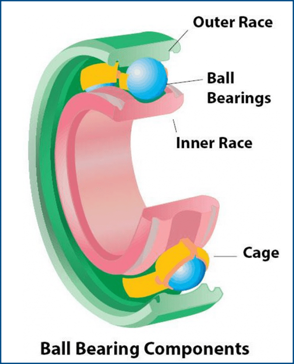

The insides of a bearing consist of four important components. The inner and outer raceways form a path for the rolling elements to glide on a thin film of lubricant. A metal cage separates the rolling elements, keeping them evenly spaced to distribute the load and stop them from crashing into one another. These four components move in concert, producing frictional forces from rotational inertia, surface load, misalignment, imbalance, and defects. Zero friction is impossible, but optimal levels of friction are achievable with correct installation techniques and the proper amounts of lubricant.
               Figure 1 – Basic Bearing Anatomy
