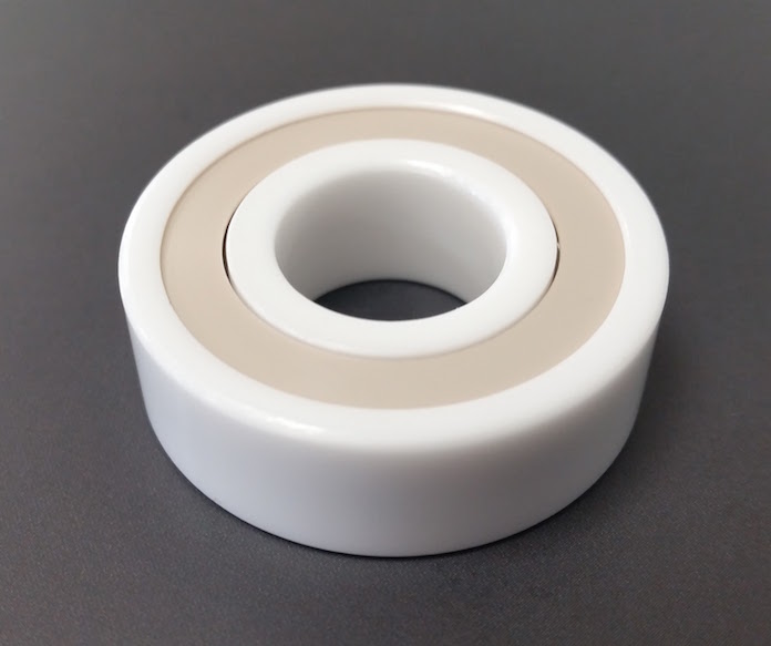

Humans have been using ceramics for domestic and industrial applications since around 25,000 BC. The material is hard, resistant to wear, chemically and thermally stable and an electrical insulator, so manufacturers can use this material for a wide range of applications. Ceramic bearings, for example, might be more expensive than steel, but provide reduced friction, reduced weight and have the potential to last much longer than the traditional stainless-steel offering, particularly in many harsh environments.

Full ceramic bearings can run constantly at speed without lubrication, so they perform well in a vacuum. When you add their low temperature capabilities, they become the ideal candidate for satellites and other projects such as the Mars Exploration Rover, especially as Mars can face temperatures as low as 125 degrees Celsius.
