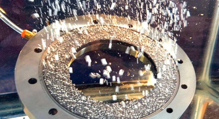

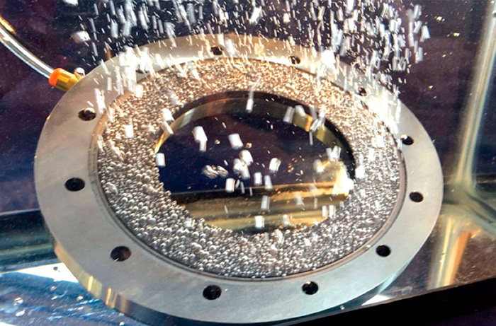

Image 1. Air bubbles emerge from an EPP gas seal face. (Images and graphics courtesy of New-Seal Inc.)

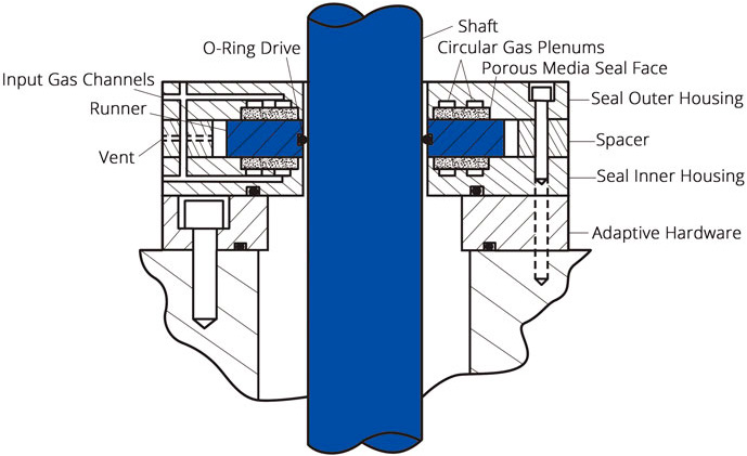

Figure 1. This diagram shows a double-opposed externally pressurized porous (EPP) gas seal.

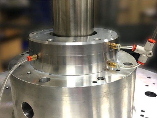

Image 2. Mounted double-opposed EPP gas seal with monitored vent

A unique feature of the externally pressurized gas seal is the O-ring drive between the runner and the shaft. This allows for easy retrofit as the runner may be positioned anywhere axially on the shaft, accommodating thermal growth of the shaft. The O-ring also allows the runner to deal with static and dynamic angular misalignment.
This concept may seem like it would not be as robust as having a feature that locks the runner to the shaft. However, because the runner-seal face interface is frictionless, the O-ring drive only needs to overcome the runner’s inertia.
Even though there are hundreds of pounds of clamping force on the runner, this force is exerted though the air films and is frictionless.
This drive mechanism has undergone thousands of hours of testing and has been successfully used in sealing applications including light gases, powders, slurries and one pump application sealing acid.
As seen in Figure 1, the external pressure is injected into the inner and outer seal housings. These ports may be connected internally, allowing for a single supply or two separate gases to be used (one for each face). The input gas flow travels into the 360-degree gas plenum regions and migrates through the porous media into the gap between the porous media face and the runner. The flow from each seal face is split.

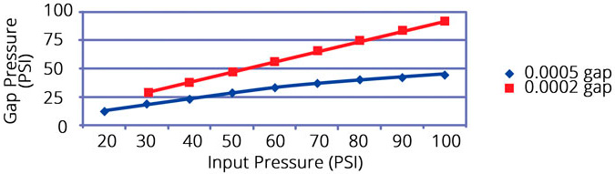

Figure 2. Gap pressure relative to starting gap clearance
On the inner side, there will be flow into the sealed cavity and the vent. On the outer side, flow will exit to the atmosphere and the vent.
As an example, using input pressure of 60 pounds per square inch gauge (psig), the gap pressure between the porous media face and the runner (assuming a 50 percent efficiency) would be approximately 30 psig. As long as this gap pressure is more than the sealed cavity pressure, there will be zero flow from the cavity into the seal gap.
A seal such as this for a 4-inch shaft will flow a total of about 0.5 standard cubic feet per minute (SCFM) for both faces. This efficiency is very sensitive to the gap; flow through a gap is a cubed function of the gap.
This is a key differentiator from more conventional seals because the small gaps allow for high gap pressures and low flows.

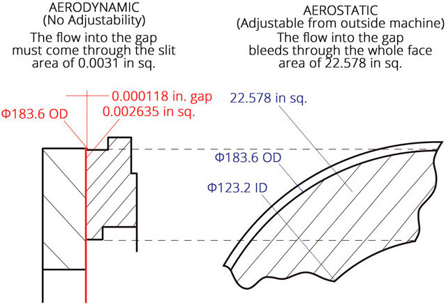

Figure 3. This diagram shows the area available for introducing gas into the seal gap.
In dry gas seals applications, externally pressurized sealing solutions may be performed with much higher pressures involved. Sealing against a 1,000 psi internal cavity pressure can be achieved as long as there is an adequate differential pressure across the porous media. In this case, an input pressure to the porous media would need to be about 1,060 psi to completely seal the 1,000 psi cavity pressure. At smaller gaps and higher pressures, efficiencies can be higher. It is necessary to keep the gap pressure higher than the pressure to be sealed.
This is another distinction between an EPP gas seal (an aerostatic seal) and a conventional aerodynamic seal, such as a dry gas seal or pump gas seal. The feed area for an externally pressurized gas seal is 4 orders of magnitude greater than that for an aerodynamic seal. This prevents choked flow and improves reliability. Controlling what gets in the seal gap improves reliability.
