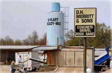

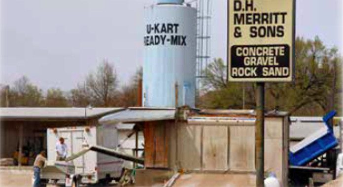

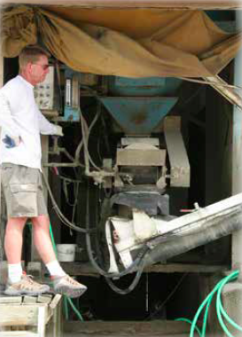

Merritt operates a small batch concrete plant manufactured by Cement Tech, Inc. in Indianola, Iowa. This equipment mixes a three yard batch of concrete and is used as needed on a daily basis during the months of March through December.
Challenge
The equipment is operated in very hot conditions during the summer months and very cold conditions during the winter months. They were experiencing bearing failures and were replacing them at mid-season, as well as the end of the season.
LE Solution
LE’s Almagard® Vari-Purpose Lubricant (3752) was recommended to be used on the bearings. Almagard 3752 is very tacky and has excellent water resistance. It also contains rust and corrosion inhibitors, extreme pressure additives and Almasol®, LE’s exclusive wear reducing additive.
Results
Bearings on the auger pump would need to be replaced at mid season and at the end of the season. Water wash down was removing the commercial grease causing the bearings to fail. With Almagard 3752, the bearings lasted all season. The customer replaced the bearings only at the end of the season and was pleased to see how good they looked.
