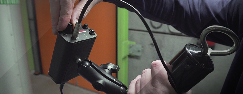

When it comes to condition-lubrication, ultrasound is the best technology. Since bearings suffer an increase in friction when they have too little or too much lubricant, and friction produces ultrasounds, we can then use ultrasonic inspection instruments to determine lubrication levels.
This is how lubrication monitoring with Ultrasound works:

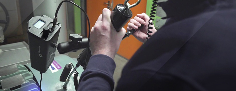

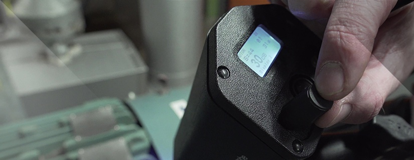

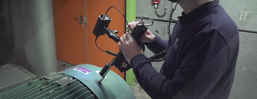

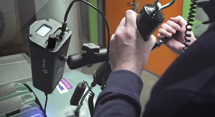

The Grease Caddies from UE Systems are examples of instruments that can be used for ultrasound-assisted lubrication. They are effective and easy to use: set a baseline for each bearing, test routinely to note decibel increases. When a bearing reaches an 8 dB gain over baseline with no change in sound quality, it needs lubrication. When applying lubricant, stop when the dB level drops to baseline. It’s just that easy!
