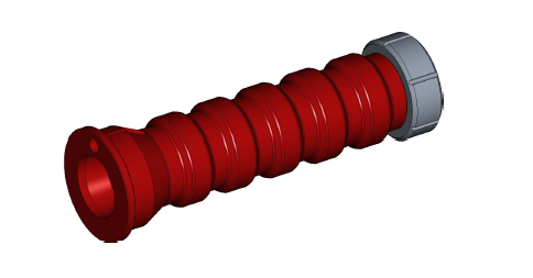

We4Ce, a Dutch supplier of rotor blade bushings, has this month filed an international patent for its “Re-FIT” bushings for on-site repair in the wind park. The new method offers up to 60 percent cost savings and eliminates months of downtime. Older turbines benefit from extended turbine lifetime as repair at the manufacturer or scrapping – the conventional alternatives – are no longer needed. A safety-critical component, blade root bushings, also called inserts, connects the rotor blade with the turbine hub.
“Damage to blade root bushings is enough of a problem to warrant more research. We believe this issue is rising, also in offshore turbines. It affects turbines of all ages, from 1.5 MW to 3 MW and 40-m to 60-m blade lengths. Usually, it occurs after the warranty period,” says Arnold Timmer, managing director of We4Ce.

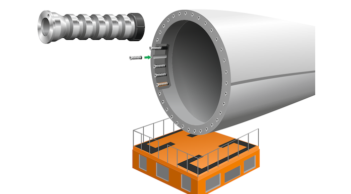

Glued into the blade during manufacture, defect bushings are complex to remove and insert to precision. A replacement bushing needs not only a strong mechanical connection but also a reliable and uniform bonding to fix the bushing within the blade, the crux of We4Ce’s patent.

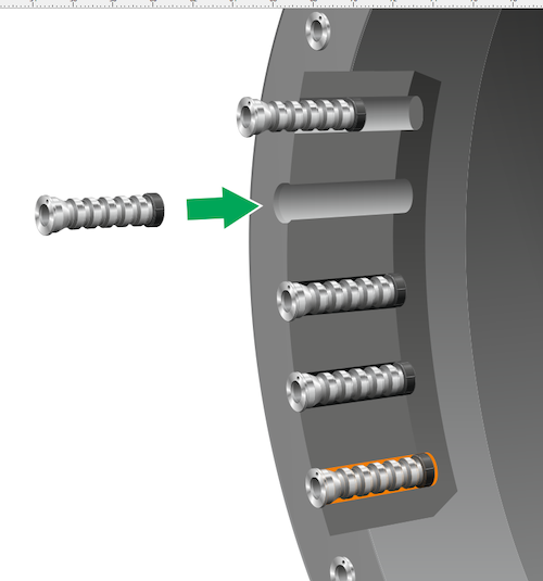

With the new repair method, the rotor blade is dismounted on-site and repaired in the wind park. The damaged bushings are extracted and replaced using precision machining. Multiple blade sets can be repaired within weeks.

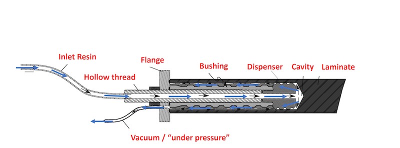

The patent covers the bonding method and design. An inlet tube placed into the hollow of the bushing is used to infuse epoxy resin into the extremities of the bushing where a proprietary steel resin dispenser has been fixed. The resin is then evenly distributed around the outside of the bushing using vacuum processing, which allows the bonding material to flow uniformly up towards the flange of the bushing. The chosen diameter of the circular dispenser aids the centering and precise placement of the component, previously a challenge.
We4Ce’s repairs offer up to 60 percent savings compared with the cost of a new blade. The solution is suitable for wind parks with more than 10 damaged blade roots. This calculation includes the setup costs and use of a specialized CNC on-site machine drilling out the damaged inserts. Loose bushings are usually detected during inspection of the blade root connection. Cracks in the sealant between pitch bearing and blade root can indicate a loose bushing.
