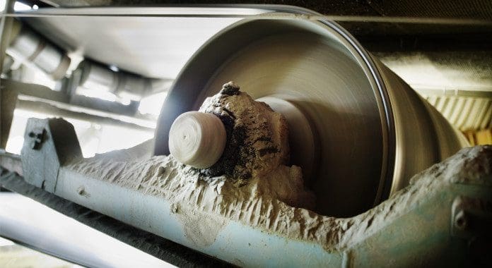

In some applications, rolling bearings can suffer a substantial loss of material (wear) due to lack of lubrication, the presence of abrasive particles, corrosion, oscillating rotation and other causes. Such wear can in turn have a detrimental effect on bearing operation, from the reduction of preload to potentially catastrophic effects. One common and perhaps unexpected consequence of uneven wear in the bearing raceways is the increasing possibility of surface fatigue. In some applications, it is not uncommon to see bands of surface distress or surface spalling along the raceways. This is associated with the possibility of raceway profile modification from uneven wear, which can give rise to stress concentration in the lines of high pressure and lower film thickness.

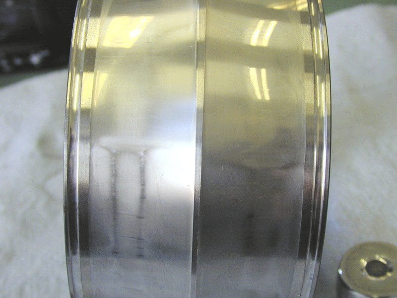

Rolling bearings operating under poor lubrication conditions in situations of uneven sliding or with the presence of abrasive particles or contamination from liquids can suffer substantial modifications in the raceway profiles (fig. 1). In time, these modifications can develop stress concentrations in the most loaded areas (fig. 2), which potentially can lead to an increase of localized surface fatigue, producing bands of micro-spalling or spalling along the raceways in the areas of higher stress (fig. 3). This potential damage mode can affect any rolling bearing, but applications with the presence of heavy contamination, corrosion, poor lubrication and uneven sliding or variable loading will be the most affected. Typically, examples are found in the mining industry, pulp and paper, wind applications and other areas.
