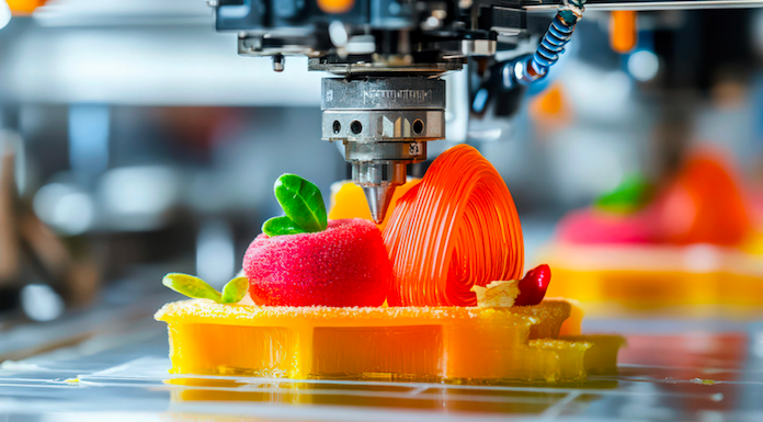

  • Additive manufacturing. 3D printers aren’t just for plastics. Various machines can extrude or sinter ingredients into edible food creations like cakes, pastas and cultured meats. Linear bearings guide the print head or print bed to build layers and shapes for artistic or functional designs
Linear bearings can be found in the print head or print bed of 3D printers that create intricate food products

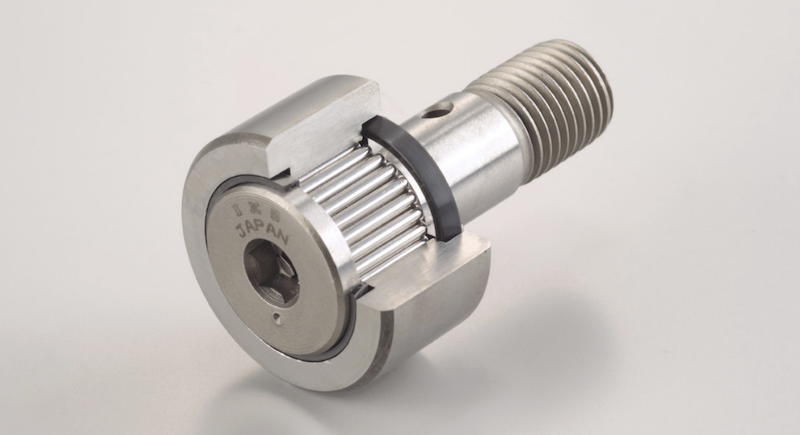

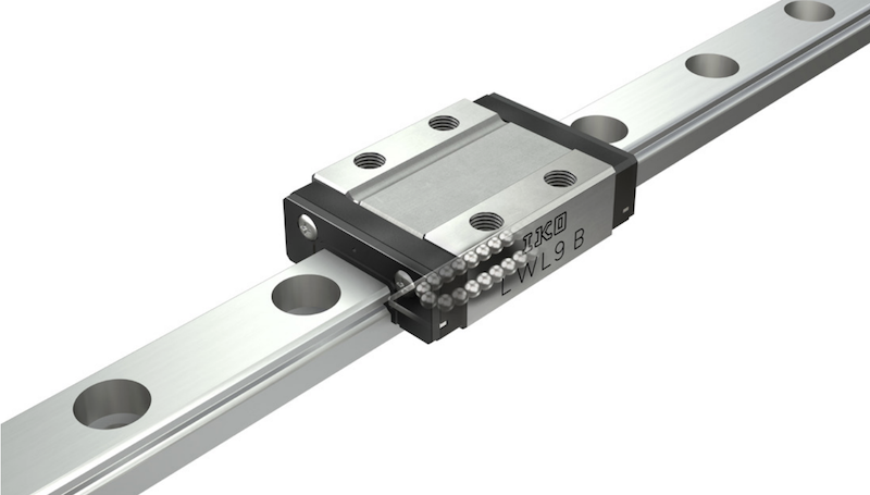

As you begin evaluating motion components for your automated food application, there are many things to look for in a supplier. At IKO, for example, we offer a wide range of durable motion components in stainless steel versions, and a host of accessories and application support to ensure your part performs reliably and safely where messy food ingredients and high-pressure washdowns are prevalent. Our products lineup features linear guides in stainless steel versions and multiple sizes for superior corrosion resistance; CRBs with rollers alternately crossed at right angles to each other between inner and outer rings to handle loads from any direction at the same time, making them desirable for robotic end effectors that handle soft food items or in any other equipment with tight spaces; and bushings and cam followers with special design elements that are well-suited for use in food production equipment. Cam followers with IKO ThrustDisk™ technology, for example, feature a synthetic resin seal that prevents wear and contamination.
IKO’s stainless steel LWL linear motion rolling guides come in compact sizes with thin track widths for space-constrained automated equipment.

Cam followers with IKO ThrustDisk technology offer exceptional wear and contamination resistance.
