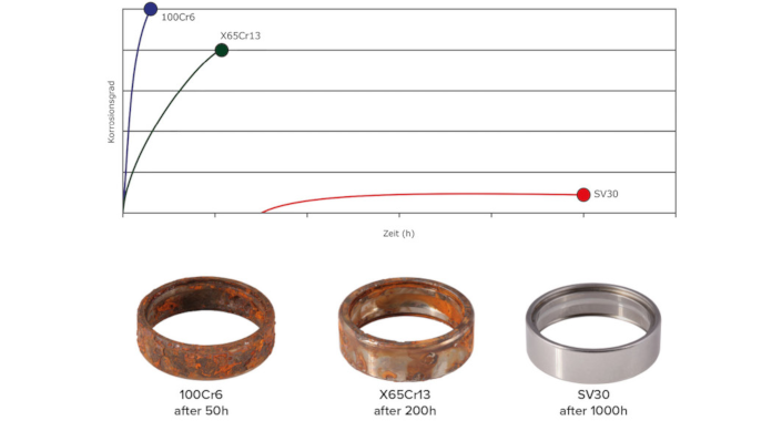

The graph shows the degree of corrosion over time for three materials SV30, X65Cr13 and 100Cr6 following controlled salt-spray tests.

Materials are a vital consideration for corrosive environments. Standard bearing steels readily corrode, leading to early bearing failure. In this case, SV30 ring material with ceramic balls should be considered as they are highly resistant to corrosion. In fact, studies have shown that SV30 material can last many times longer than other corrosion resistant steel in a salt spray environment. In controlled salt-spray tests SV30 steel only shows slight signs of corrosion after 1,000 hours of salt spray testing (see graph 1) and SV30’s high corrosion resistance is clearly seen on the test rings. Special ceramic ball materials such as Zirconia and Silicon Carbide can also be used to further increase a bearing’s resistance to corrosive substances.
