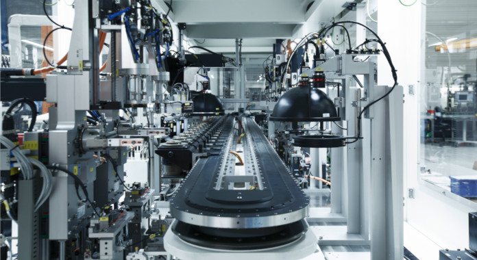

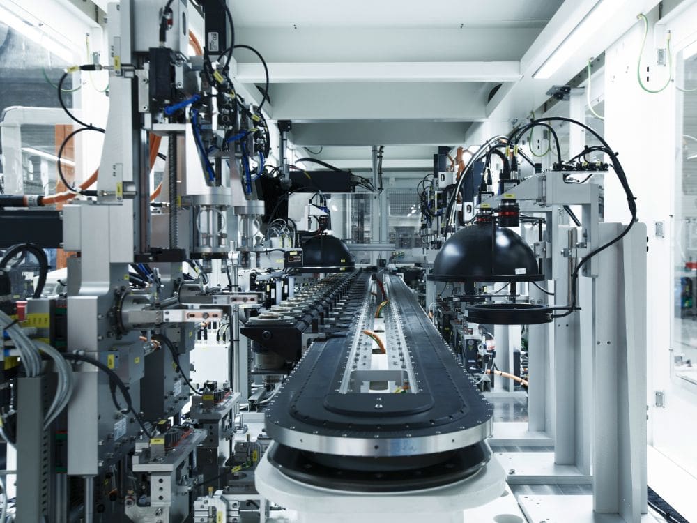

Gefasoft, Germany, a developer of automation systems, designed a system for the inspection of automotive diffusers in such a way that batch sizes can be changed and, if required, additional work steps can be integrated to the process. This was achieved with the combination of Beckhoff’s XTS system and Hepco’s GFX system. Thanks to the ability to individually control movers on the XTS, on the fly product changes are possible and additional steps can be included with the modification of software. The HepcoMotion 1-Trak-based GFX system was the perfect companion; the GFX system can accommodate higher loads and accelerations with improved life capacity whilst maintaining the positioning accuracy required. In addition, the carriages on the GFX system can easily be adjusted and maintained thanks to a small section of removable track, something of great importance in this system.
For Bosch Packaging Technology, the GFX and XTS systems were the ideal solution for combining three functions in a single machine. The Integrated Topload Cartoner, Kliklok ITC, straightens, loads and seals boxes of confectionary. With the combination of various individual functions in a single machine, it was necessary to maintain flexibility, for example allowing different sizes of carton to be processed. Hepco ‘s three-bearing GFX mover is a lightweight carriage which offers smoother, quieter and faster movement than could be achieved with conventional guide systems.
