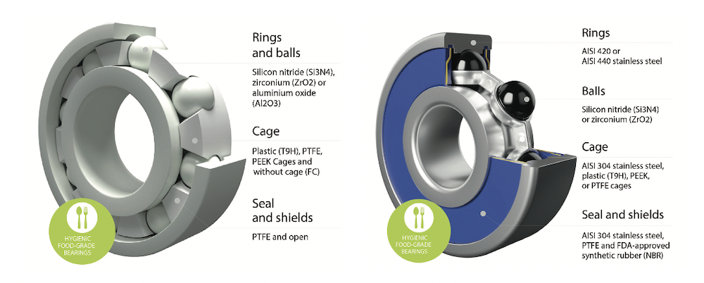

Food safe Ball Bearings:

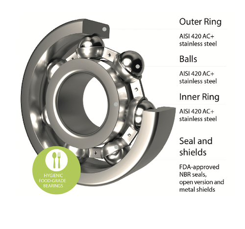

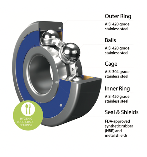

Stainless Steel FBS Bearings
FDA-compliant AISI 420 and AISI 304 stainless steel.- Exceptional corrosion and extreme temperature resistance.
- Endures frequent high-pressure washing and chemicals.
- Non-toxic, easy to clean, and non-porous.
- Handles high loads and vibrations for extended life.
- Equipped with FDA-approved NBR seals and metal shields for lubricant retention and corrosion prevention.
- NBR seals that resist oils, fats, mould, and water, maintaining food integrity.
- Supplied with FDA-compliant MobilgreaseTM FM (NSF H1 Registered, Kosher/Parve, and Halal compliant).
AISI 420 AC+ FBS Bearings
Enhanced with a special surface treatment developed by their engineers.- Lasts twice as long as standard stainless steel bearings, cutting replacement costs and downtime due to corrosion.
- Virtually untouched by corrosion after 120 hours of Salt Spray testing.
- Compliance with FDA and RoHS standards.
- Supplied with FDA-compliant MobilgreaseTM (FM NSF H1 Registered, Kosher/Parve, and Halal compliant).
Ceramic & Hybrid FBS Bearings
- Ideal for food applications requiring superior corrosion resistance and higher temperature capabilities than stainless steel bearings.
- Excellent durability against continuous exposure to water, harsh chemicals, acids, and alkalis, minimising maintenance requirements.
- Low friction coefficient contributes to cost savings through extended lifespan, reduced lubrication needs, and lower energy consumption.
- Equipped with PTFE seals providing excellent thermal stability and optimal resistance to industry cleaners and disinfectants, effectively protecting against contamination.
- Full Ceramic FBS Bearings can run lubrication-free, and Hybrid FBS Bearings require less lubrication than stainless steel bearings due to their lower friction coefficient and lighter balls.

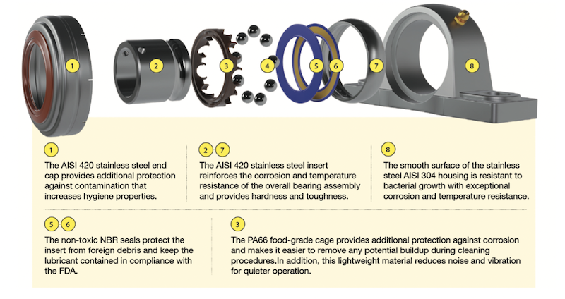

FBS Stainless Steel Housings with stainless steel inserts:
- Made in AISI 304 stainless steel, which provides excellent corrosion and temperature resistance.
- Protection against rust and damage from moisture, liquids, and cleaning agents.
- Smooth surface that is easy to clean, promoting hygiene and reducing the risk of contamination.
- Strong, durable, and can withstand heavy loads, impacts, and frequent use, minimising downtime and maintenance costs.
- Lubricated with FDA-compliant MobilgreaseTM FM. NSF H1 Registered, Kosher/Parve, and Halal compliant).

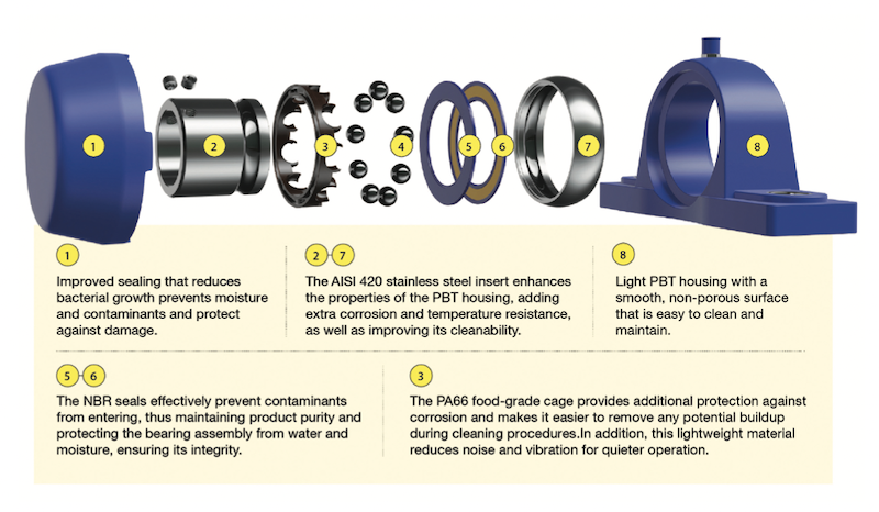

FBS thermoplastic housings with stainless steel inserts:
- Made of PBT, known for excellent chemical resistance.
- Withstand acidic or alkaline substances and sanitising solutions without damage or corrosion.
- Smooth, easy-to-clean surface that reduces bacterial growth and promotes hygiene.
- Provides insulation and protection for internal electronic components, ensuring safe operation in food and beverage applications.
- Lubricated with FDA-compliant MobilgreaseTM (FM NSF H1 Registered, Kosher/Parve, and Halal compliant).
