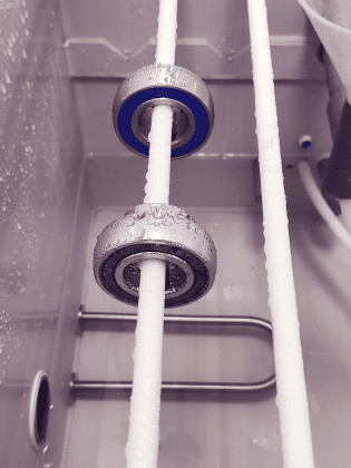

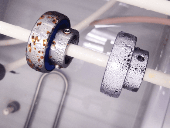

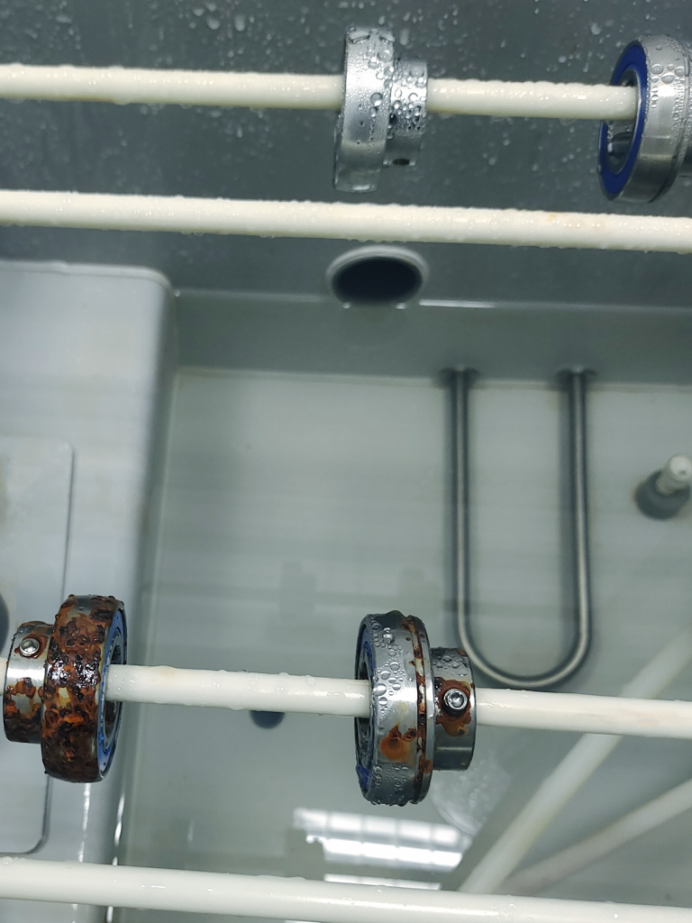

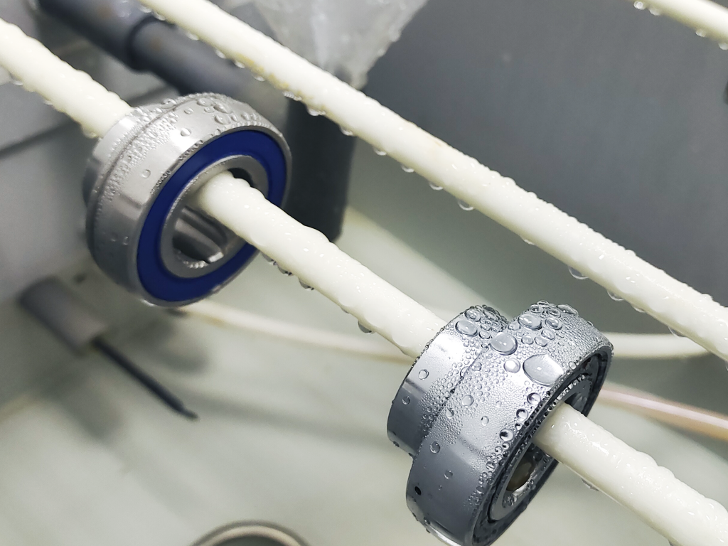

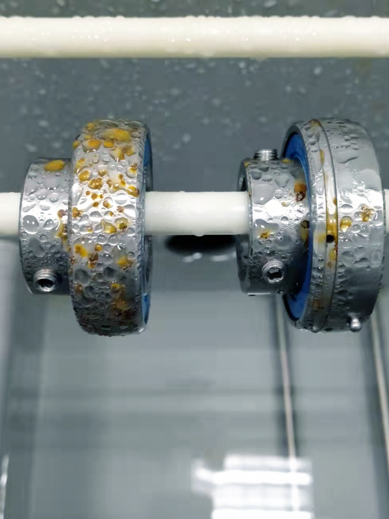

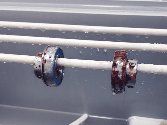

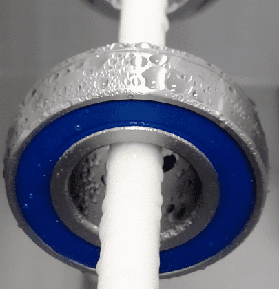

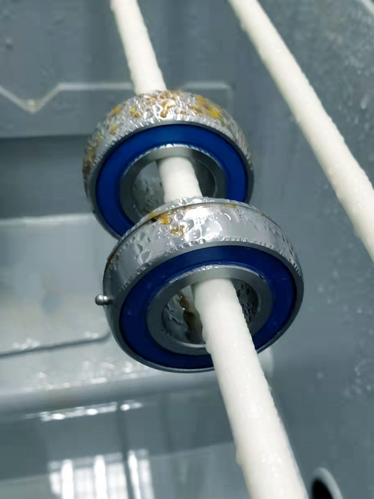

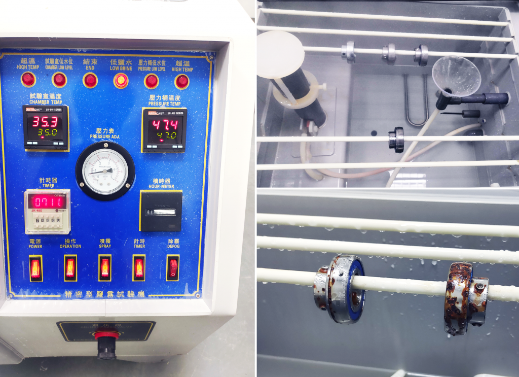

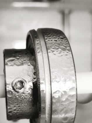

To test and show us the corrosion resistance of these bearings, Mr Yago Zens exposed three samples of different types of stainless steel bearings to a 120 hours salt spray test including the new AISI 420 AC+.
The three samples tested were as follows:
A = AISI 420 stainless steel.
B = AISI 420 stainless steel AC+
C = AISI 440 stainless steel.
The Salt Spray Test is an accelerated corrosion test that produces a corrosive attack on the tested samples to predict their corrosion resistance.
The appearance of corrosion products (oxides) is evaluated after a period of time. Test duration depends on the corrosion resistance of the material the more corrosion resistant the material is, the longer the period in testing without showing signs of corrosion.The standard testing period for ball bearings is 120 hours.
As we can see, after 120 hours of testing, the AISI 420 stainless steel AC+ has remained virtually untouched by corrosion. There is no rust mark on the inner and outer ring of the bearing, only some rust spots on the oil groove.
