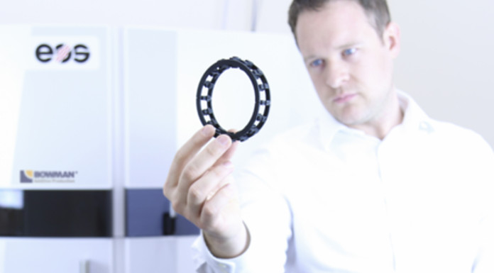

Bowman International, a leading innovator in bearing design and manufacture, has introduced to the market a revolutionary bearing cage, designed to offer up to three times longer life expectancy and 40% higher load bearing capacity. In an industry where increasing bearing performance by as little as 5-10% is considered significant, Bowman’s patent pending ‘Evolution’ cage technology is truly a stand-out innovation.

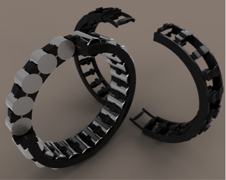

Split bearing cages
The Evolution cage boasts a unique interlocking structure which uses the rolling elements to pin together each section of the cage. This revolutionary, design creates enough additional space around the circumference of the cage to incorporate two to four* more rollers than comparative products.
It is these additional rollers which allow the load to be spread over a higher number rolling elements that increase the performance of the overall cage, making it a suitable specification choice for any application which would benefit from higher load capacity or extended life expectancy, without having to amend any other part of the bearing assembly.
Jacob Turner, head of Bowman Additive Production explains: “By using the roller to pin together the cage structure, we essentially create additional space for more rollers, increasing the load bearing capacity and therefore lifespan of the component.
“This unique structure also facilitates easy mounting and maintenance with no fiddly pins or clips to manoeuvre or maintain.”

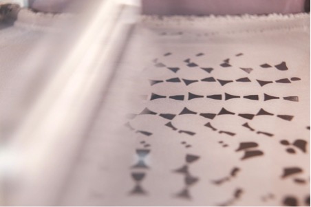

Jacob Turner adds: “The Evolution cage combines the very latest in SLS (Selective Laser Sintering) 3D printing with world-renowned materials science. Together, this offers OEMs and plant maintenance engineers a split bearing cage which delivers superior performance and longer product life, alongside simplified mounting and maintenance procedures – not forgetting less vibration and noise during operation.
“The cage design integrates a number of complex forms, which means additive production with Nylon 11 is the only manufacturing method capable of bringing this concept to reality in an economically viable way. Combining this new production method with Bowman’s extensive experience in materials innovation has proved a formula for success for the split bearing market.”
High grade Nylon 11, or PA1102, is Bowman’s preferred choice of additive manufacturing material – a polyamide characterised by its elasticity and high impact resistance. Whilst most manufacturers remain focussed on using aesthetically tuned materials for visual prototyping, Bowman AP will join a select group of companies in the UK able to offer this engineering specific material for the production of functional parts.
