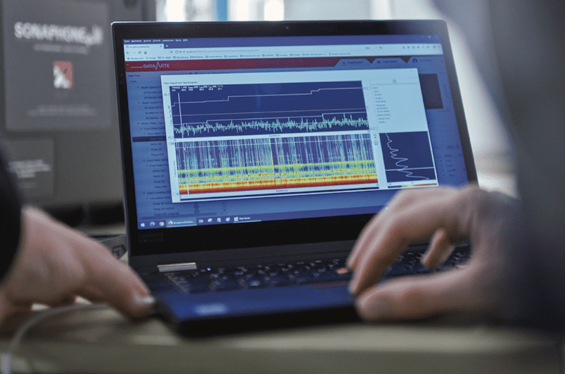

With the intuitive LevelMeter App, the digital ultrasonic testing device SONAPHONE® enables broadband measurements and characteristic value determination. Due to its high sampling rate of 256 kS/s, signals up to 128 kHz can be analyzed. Up to this limit, characteristic values can be calculated and audio signals can be generated based on the filter settings. The device offers two methods for transforming the ultrasonic signals into the audible frequency range. The heterodyne method is used when a narrow-band transformation (bandwidth 4 kHz) is realized, while the vocoder method is suitable for a broadband transformation. The live signal is shown as time wave form, level graph and spectrogram.
Excellence in condition monitoring program
A great and powerful combination of the SONAPHONE®, the intuitive LevelMeter App, the broadband BS40 sensor and the software for the management of predictive maintenance tasks DataSuite helps to achieve excellence in an ultrasound condition monitoring program. This holistic ultrasonic solution helps the maintenance team to ensure that manufacturing processes in the industrial facility are running smoothly. Lubrication decisions can be made based on the acoustic feedback of bearings. Furthermore, companies are able to act in advance when bearings replacements become imminent as an early intervention can help to omit significant issues. It is now easy to recognize bearing damage early and optimize their lubrication with ultrasonic testing devices developed and manufactured in Germany.
