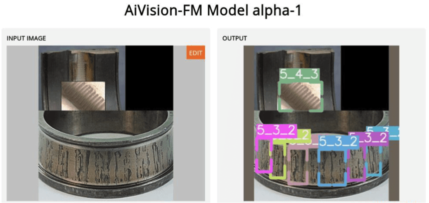

SKF REPaIR (Rotating Equipment Performance aided by Innovative Remanufacturing) is a multi-pronged R&D effort that looks at the complete remanufacturing value chain. Innovation begins at the customer plant, with an automated machine vision system that can evaluate bearing damage using digital photographs. The system uses AI, in the form of a deep neural network image recognition algorithm, which has been trained to detect and classify specific damages in bearings.
Unlike older machine vision approaches, SKF’s AI vision system has been designed to operate in real-world conditions, where images may be obtained on the factory floor or in the field and tight control over lighting and composition are impossible. The system can identify the bearing surface even if the image is captured in suboptimal conditions.
SKF’s system is in the future expected to provide an initial “go/no-go” evaluation of a bearing which would indicate to the customer whether the component is suitable for remanufacturing or not. In the latter case, it is probably more cost-efficient to responsibly recycle the bearing locally. This new AI vision system is explained in detail in a recent EVOLUTION article “The future of bearing failure analysis is here”.
