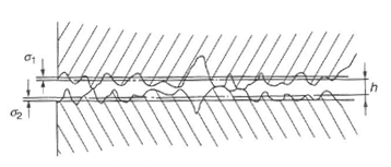

Shearing of the lubricant in areas of ball bearing contact
The primary role of a lubricant is to prevent metal-on-metal contact of the rings and balls, by separating the surfaces with a thin film. The asperities of the surfaces are thus excluded and do not come into collision, which allows for significant improvement and a longer service life of the product. The most common lubrication is lifetime lubrication with grease which offers ease of implementation. However, lubrication with circulating oil is sometimes necessary.
Figure 2: Detail of surface ball-rings in contact with mixed lubricants. In this method occasional contact of surfaces is possible. [Tedric A. Harris, 2007, Advanced Concepts of Bearing Technology, CRC Taylor & Francis Group, 140]
The choice of the viscosity and the type of base oil is critical to ensure optimal lubricant film thickness. A too high viscosity will cause unnecessary friction and temperature increase, while a low viscosity will cause friction of mixed types and limited collision of the asperities of the surfaces which results in a severe reduction in energy and life expectancy. There is no universal grease suitable for all applications. A grease measured accordingly, depending on the application, will optimize the lubricant film thickness and thus reduce the friction as well as extend the life expectancy.

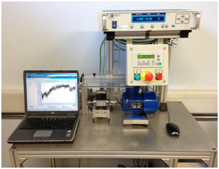

Practical validation
It is difficult to accurately calculate the friction of a bearing, as the number of parameters that influence this value are more diverse. Certain programs are used to calculate a relatively accurate friction value for standard bearings, but the results may strongly diverge from reality, for special bearings.
JESA is equipped with a test bench to measure the friction of bearings for different methods of rotation. A practical validation calculation is made on this bench, so as to ensure the friction level of real products.
Figure 8 Bench test for measuring friction torque

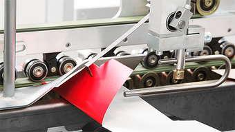

Specific example
Bobst SA is one of the world leading companies involved in the design and manufacture of machines for production of cardboard packaging. Some of these machines are large and utilize hundreds of bearings to support and guide flat belts, which are used to move the cartons through the machine.
These bearings are specifically for low loads and as standard bearings they are not adapted and optimized for heavy loads. JESA SA has proposed a special bearing optimized according to the needs and responsibilities of the customer. The construction and internal geometry have been revised as well as the quantity and type of lubricant used. These special no contact double-joints provide a good seal to the cardboard without effecting friction.
Figure 11 Detail rolling folder-gluer BOBST [www.bobst.com]

With such a product, it is possible to divide by 2, or even 3, the friction of the bearings. As one multiplies the amount of bearings per machine, significant energy savings can be achieved on the final product. The impact of the machine on the environment is reduced and lower operating costs are obtained.
