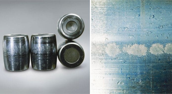

Peeling 1
Part: Inner ring of a spherical roller bearing
Symptom: Rounded areas of Peeling
Cause: Poor lubrication
Peeling 2
Part: Enlargement of damage “Peeling 1”
Peeling 3
Part: Convex rollers of damage “Peeling 1”
Symptom: Rounded areas of Peeling on the center of the rolling surfaces
Peeling 4
Part: Outer ring of a spherical roller bearing
Symptom: Peeling occurs near the shoulder of the raceway over the entire circumference
