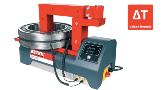

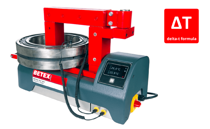

Bega Special Tools have launched a new generation of SMART BETEX® low & middle frequency induction heaters, where full control over the heating process can be exercised. These heaters are suitable for middle sized and large bearings (or other parts).

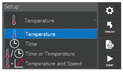

modes.
Specially designed for industrial use, the heaters have an easy to use touchscreen with many heating options. More important: these heaters are fitted with a Delta T control system. Two temperature sensors measure the inside and the outside temperature of the bearing (part) and adjust the heating according to the selected variable settings. In this way the maximum permitted temperature difference between 2 points can never be exceeded. An even and uniform heating is achieved, and material stress is avoided. Heaters have a USB port for logging purposes. Nowadays it is becoming more and more important to be able to store heating data or to create a proof of work report.
