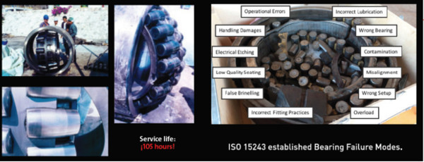

- To emphasize the importance of understanding the different bearing failure modes according to the ISO 15243 will also be pointed out as these in many cases will clearly and directly indicate the failure causes.

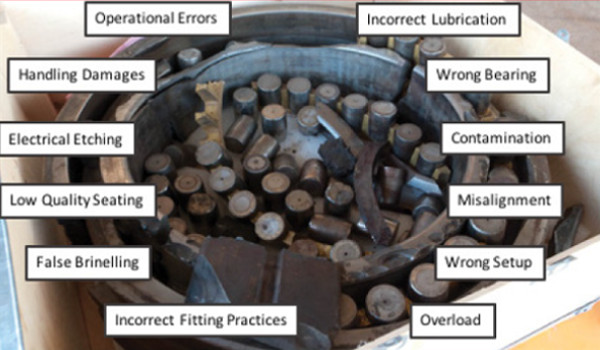

Failure of a large bearing in a cement mill
- It may be very simple when you have the knowledge. By knowing the most common causes for bearing failures and the different bearing modes it will in many cases be very easy to identify the failure root cause and logically to immediately indicate the required corrective action.

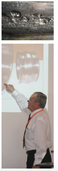

- Fatigue:Subsurface initiated fatigue Surface initiated fatigue
- Wear: Abrasive wear Adhesive wear
- Corrosion: Moisture corrosion Fretting corrosion False Brinelling
- Electrical erosion: Excessive voltage Current leakage
- Plastic deformation: Overload Indentation from debris Indentation by handling
- Fracture and cracking: Forced fracture Fatigue fracture Thermal cracking
