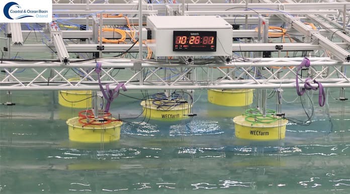

The experimental setup was tested in the Coastal & Ocean Basin Ostend, Belgium, which is a wave basin with an L-shaped wavemaker of 20 by 20 m. Figure 3 and 4 show the experimental setup of the five-WEC array at the wave basin. To maximize power absorption, a control system tailored to the WEC array needs to be implemented. Control strategies aim to achieve resonance by altering the dynamics of the WEC system, as most power is produced during resonant absorption. The research team investigated how the WEC array layout should be optimized simultaneously with the applied control strategy to maximize the power absorption. System identification tests were executed to obtain an accurate dynamic model of the WEC array. Proportional (resistive) and Proportional-Integral (reactive) controllers were designed and tested accordingly.
