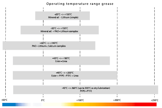

With increasing temperatures the viscosity of oil (oil in the grease) is getting lower, the oil is not anymore capable of separating the rolling elements from the raceway. The metal to metal contact increases wear and causes premature bearing failure.
Grease is ageing quickly at higher temperatures, permanent regreasing is expensive. Excessive grease will be around the bearing (danger of fire!) and old grease in the bearing tends to carbonize.
The todays absolute temperature limit for grease is 260°C, above that level solid lubricants like MoS2, PTFE or graphite Durolub SLC The Durolub SLC is a solid compound consisting of a mix of dry-lubricants with high temperature resistant bonding agents. It is filled into the free space of the bearing and thermally treated. After hardening, the solid compound is moving with the cage and the rolling elements around the bearing. While moving small quantities of the dry lubricant are transferred onto the raceway and rolling elements and build an approx.
