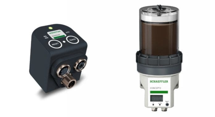

In a recent example in Belgium, SmartCheck condition monitoring devices and CONCEPT2 automatic lubricators were installed on flood pumps and motors. Schaeffler’s Belgian customer has since seen a range of benefits, including the prevention of unplanned downtime to pumping stations, reduced maintenance costs and increased plant availability.

Schaeffler experts recommended installing six CONCEPT2 automatic lubrication systems for lubrication of bearings in the motors and pumps. This solutions permits ongoing and reliable lubrication of the bearings. CONCEPT2 supplies two lubrication points independently of each other and withstands pressures up to 50 bar.
Schaeffler also recommended installing nine SmartCheck condition monitoring devices to monitor the three pump/motor units. Two SmartChecks are installed per unit to monitor the upper and lower motor bearings, plus an additional SmartCheck on each of the pump bearings.
Any deviations or changes in vibration behaviour are detected by SmartCheck and reported via the customer’s control system, thus allowing incipient bearing damage to be detected at an early stage. Monitored parameters include vibration, temperature, speed and cavitation.
The local dealer Supplimax, a certified Schaeffler partner, recommended the systems and will be providing future on-site service advice.
