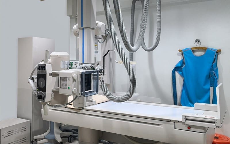

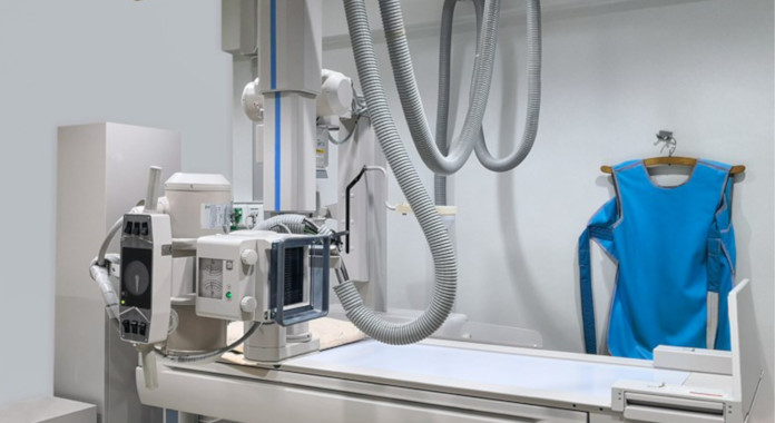

                                     X-ray medical scan machine room with radiation protection vest in hospital
