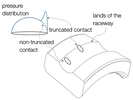

- Can the momentarily occurring shock loads seen during launch be accommodated in such a way that they will not affect the normal operation of the bearing during its normal duty cycle?
- Is the level of damage, under these shock loads, that might occur to the bearing raceway and lands due to the ball moving to the track edge, so called truncation, be considered acceptable (refer to Figure 1)?
- Do we need to employ a bigger size of bearing for the application?

Based on the loading situation, resulting contact angles and pressure distribution (refer to Figure 3 b) can be determined. This makes possible to identify whether, under the shock loads, truncation of the contact ellipse occurred or not. Because this is a critical situation, that one should avoid. The maximum resulting rolling element load is extracted and used as an input for FE-Contact simulation.

- Design Changes: We need to think of adapting the shoulder height of the raceway lands to avoid the truncation of the contact region if we recognize the problem with the selected bearing.
