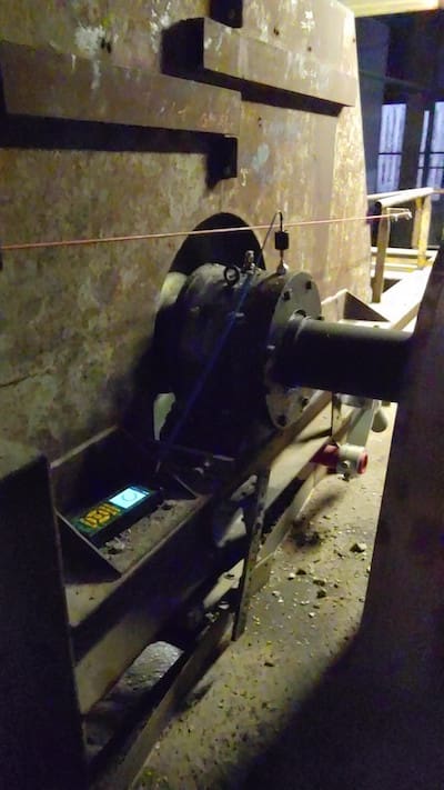

Recently, SDT International took up this challenge on a rotating machine with a rotation speed of 8 RPM.
More than a week earlier, the maintenance department of a world-renowned company had detected unusual noise on a strategic production asset. The sudden stop of this machine would have led to the complete shutdown of the production site. Not to mention the financial cost of replacing these 4 bearings, the time required for the procurement of these specific bearings and the cost of the maintenance labour.
There was a dual stake here: control the condition of these bearings and attempt to detect the origin of this noise.
A diagnosis could be issued using the new ultrasonic measuring instrument, SDT340, and its FOCUS mode that can generate sampling frequencies up to 256 K samples per second.
The spectrum shows an impact at the rotation speed (0.139 Hz) of the shafts of the rotating machine, along with its harmonics. Sub-harmonic frequencies can also be observed at 0.5 x the rotation speed, which is a characteristic spectrum for a rotational clearance due to friction or significant impacts. No impact due to bearing frequencies are observed. Our diagnosis is confirmed by the time spectrum.
In terms of energy, these impacts are not necessarily constant for each shaft revolution (time signal recorded over a period of 2 minutes).
The encountered problem is due to the wear of the shafts and of the disks that are mounted onto these shafts and generate friction.
Now, the maintenance department knows the origin of the noise and the condition of the bearings, which just need to be monitored on a periodic basis.
