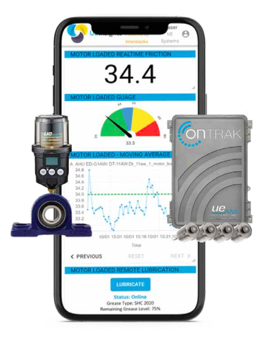

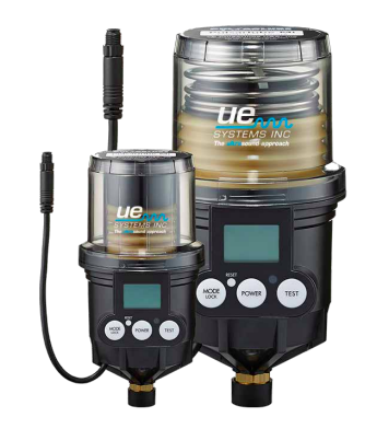

A single-point automatic lubrication system can deliver the right amount of grease at the right time to each lubrication point. This reduces both grease waste and the risk of bearing failure. Especially when such system is coupled with ultrasonic sensors and a remote monitoring system, lubricating based on bearings’ condition, assuring perfect lubrication at the right time, always. One good example is the OnTrak & Smartlube from UE Systems.

By comparison, a properly installed single-point automatic lubricator can supply a continuous and accurate flow of fresh and clean lubricant, keeping the application in proper condition while at the same time preventing contaminant ingress.
